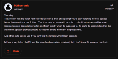

  • Over one year later and this bug has recently reappeared.......
    Whats going on?????
    And still NOT fixed in the most recent update:
