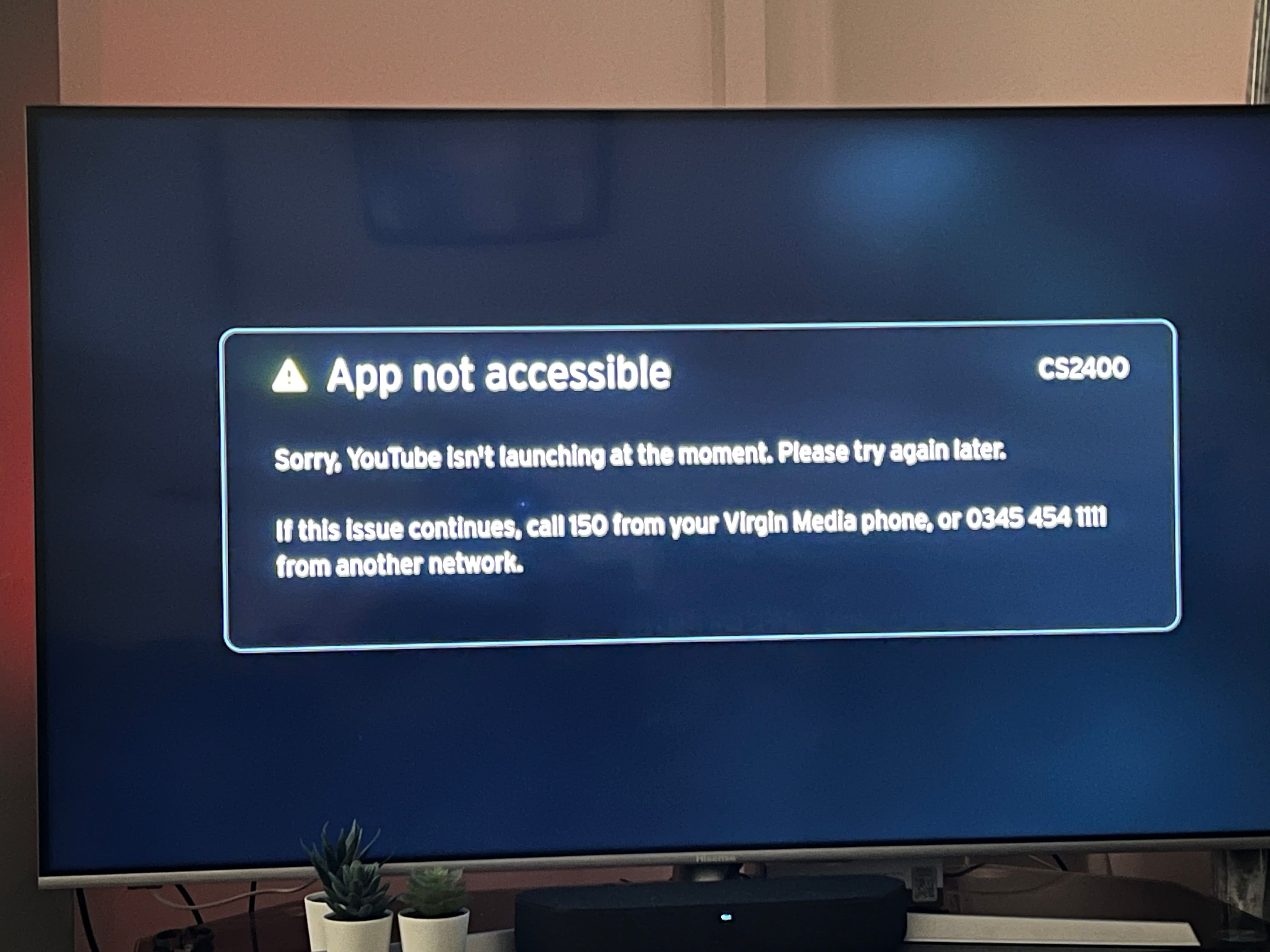

    • WhaleTrain's avatar
      WhaleTrain
      Thanks for responding.
      Please see below my image, this is also starting to happen with YouTube - I believe this is the same error code as Netflix also:
      • Matthew_ML's avatar
        Matthew_ML
        Thank you for sending this over, just to confirm this is happening with Netflix and YouTube?
        How long has this been happening?
