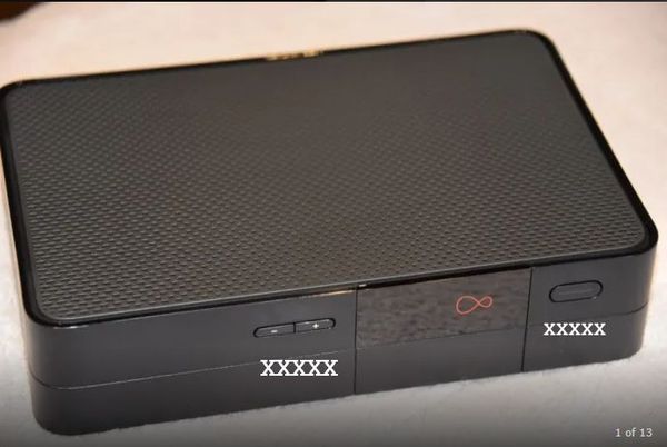

  • Hi Jim,
    Try turning off the 360 by the switch on the back of the box;  then on the front of the 360 box  hold down both the standby/power button and the - (minus) button at the same time. Then turn on the 360 again whilst keeping hold of those buttons for a further 30 seconds.
    If the standby/power button and the -  button workaround doesn't solve it then try using the standby/power button and the + (plus) button at the same time instead.
    You could also try the three fingered salute, which is switch off on the back of the box;  then on the front hold down the plus, minus and standby/power buttons at the same time, and switch on again whilst keeping all three buttons pressed down.  When it restarts you might see a message it can't acquire the channels. If so press OK and let it restart again.
    As to reporting the fault if the above methods don't fix it -  select option 2 (faults)  by either dialling 150 from a VM landline (it's a free call) or by dialling 0345 454 1111  option 2 from any other phone.

  • If the working box is connected by ethernet cable you could try swapping the boxes around to see if the suspect box updates, if it doesn't then it will need replacing.
    If phoning isn't getting you anywhere you need to report back and wait for one of the forum team to respond which might be 2 to 3 days.

      Brilliant, the first method appears to have worked, I’m guessing it was a forced update as a small downloading arrow appeared onscreen several times and eventually it went into download/update mode and eventually came back on fully. Many thanks for this solution. The ‘Kudos’ button seems to have been removed so I hope a like will suffice.
