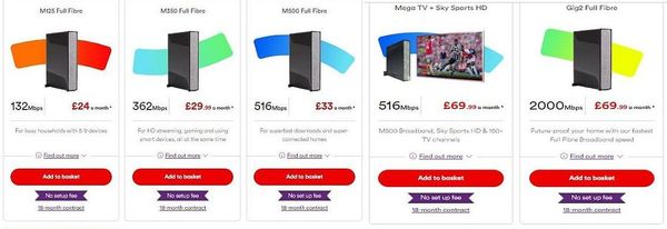

    Also if you can receive services from VM then is it the Fibre or Full Fibre service?  This will determine which type of TV service VM can provide.
    On the older DOCSIS (Fibre) network the incoming VM coaxial cable carries both the linear broadcast TV channels & the DOCSIS internet.  VM's recordable TV set top boxes (TV360) only work on the older  DOCSIS cable network which uses coaxial copper cables.   You can receive broadband speeds up to 1Gbps on this network.
    VM's DOCSIS and XGS PON aren't compatable as without coaxial there are no traditional cable television signals just internet, so VM provide their TV service on the  Full Fibre  network over the internet using the Stream (Flex) box, hence no recording facilities. (Full Fibre (XGS-PON) is fibre to the premises and is VM's newest network currently offering speeds up to 2Gbps symmetrically and will be capable of 10Gbps symmetric speeds in the future.
    Also, customers on the new full fibre to the premises network receive VM's latest router, the hub5x.  which doesn't have modem mode. There isn't currently a landline service on the full fibre network.
    The easy way to tell if you will be on the newer Full Fibre network is you will see the website offers speeds up to 2Gbps, also the advertised package(s) will  indicate they are full fibre as per the screenshot below.
