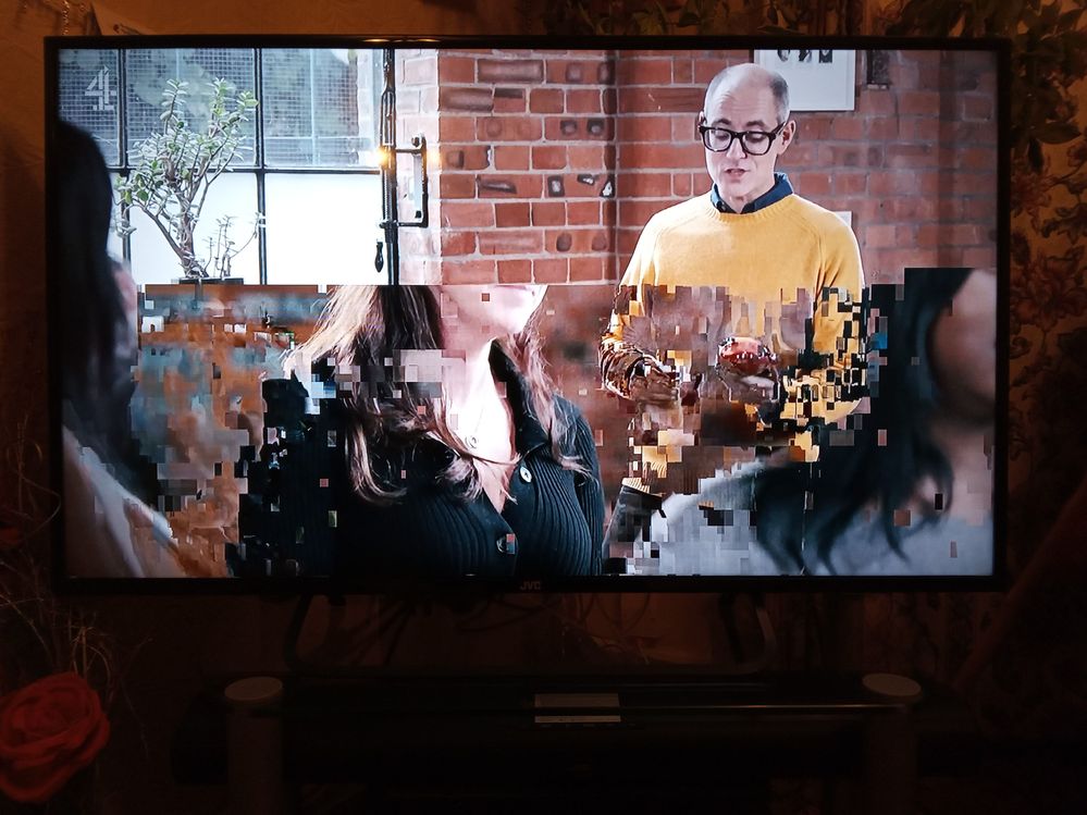

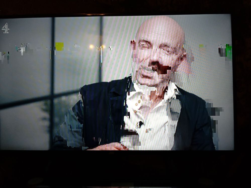

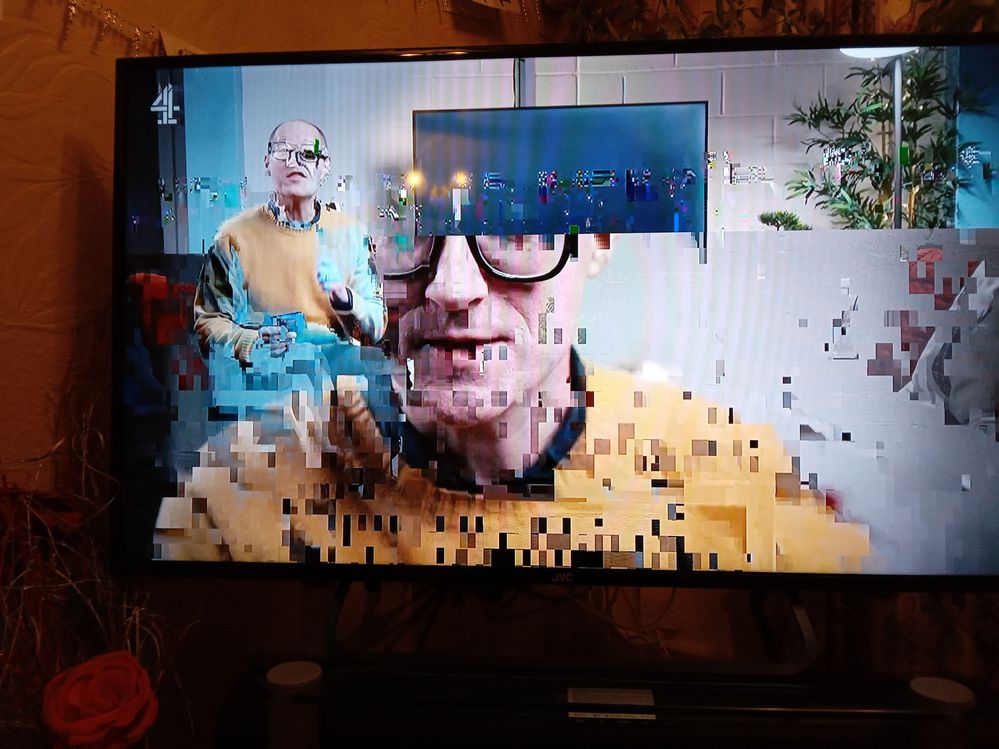

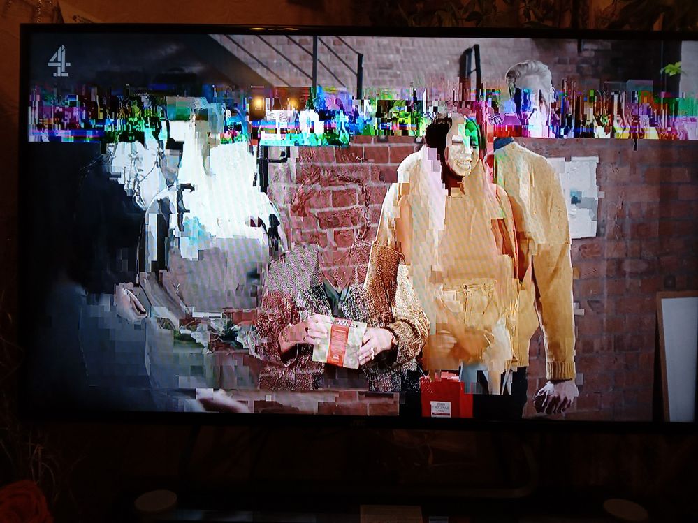

A Virgin engineer visited my home a few weeks ago to sort out a problem with live TV pictures (breaking up / pixelating). He changed some cable and this seems to have sorted the problem. However, I now have a problem with recordings made on the Tivo box. On playback, there is so much breaking up / pixelating, that it is difficult to watch the recordings, which are worse on Channel 4 and Channel 5 recordings.
Looking elsewhere in this forum it has been suggested to those with similar problems to pause live TV , then resume, to see if any breaking up occurs. In my case, it doesn't. It's on the recordings only.
