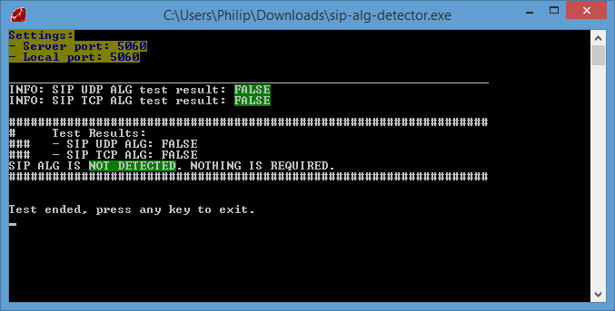

    SIP ALG - thankfully that is not a problem to be concerned about.
    SIP ALG routes inbound SIP UDP traffic on port 5060 to an ISP's internal VOIP device. This is not a problem on VM Hubs because the private VOIP circuit for a VM Hub is not part of the customers LAN traffic.

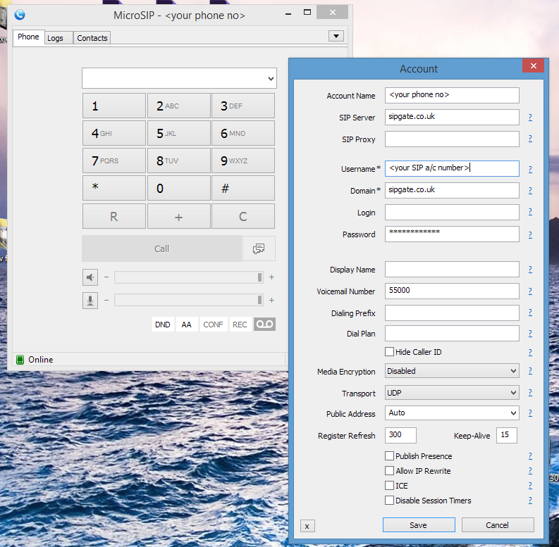

    Suggestion, download Micro SIP Lite and install on your PC or Laptop.
    https://www.microsip.org/downloads
    Register an account with one of the VOIP providers and configure the SIP a/c details in Micro SIP Lite.
    Get some first hand experience of the type of setup that is involved without having to buy any kit.
    Being able to make and receive phone calls via your VOIP provider is the best way to gain confidence that the service works. Build your confidence in the process from seeing it in action & resolving any snags or questions along the way.
    Here is an example of what is needed to connect a Sipgate VOIP SIP a/c in MicroSIP lite.
    I've entered just 6 fields to create a VOIP connection that connects to one of our three accounts. This works for in and out bound calls + dials to the voice message service.  It will work with the speakers / mic of a laptop or PC or with a headset.
    It is not much to do to get a working VOIP phone ... fancy giving that a try ?
    Oh, the stuff below the Voicemail Number is all defaults from MicroSIP Lite.
