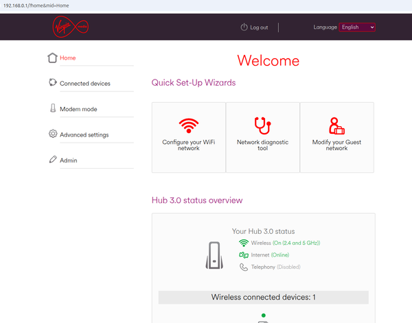

I recently received a replacement Hub 3 for one that was showing a solid red light, but I've just discovered that the phone is not working.
History, the red red light appeared on the old Hub 3 about Jan/Feb 2024 and it came with some WiFi issues intermittent loss of signal/slow down in speed/loss of internet. So I brought myself a router and switched the Hub 3 to modem mode.
And everything worked.
This year my contract was up in May and I finally got around to getting a replacement. The first one to turn up was damaged in transit (There was something loose inside the Hub). The second turned up I plugged it in changed the password and switched to Modem Mode. And then I went away on holiday.

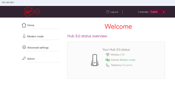

Today I go to use the phone and no dial tone. Signed into the Hub settings and it says Telephony (Disabled)
Is that because the Hub is in Modem mode, or is there another problem?
Thank you for your help

  • Hey roganty, thank you for reaching out and we are sorry to hear about your phone line issues.
    Just to confirm you are using a router which we've sent you not one that you bought?
    Have you tried it without being in modem mode?
    Have you tested the handset?
    • roganty's avatar
      roganty
      The replacement was sent from VM via Yodel and activated 21st May.
      I'm not sure how to test the handset, but I have tried phoning the landline and I go straight to voicemail.
      I did try rebooting the Hub and watching the symbols on the front and a phone symbol did not appear.
      Maybe I put the Hub in modem mode before VM had activated the new kit??
      Trying none modem mode now...
      • Matthew_ML's avatar
        Matthew_ML
        Let me send you a DM whilst you try anyway so you can update us in real time. Please look out for my DM
    Being in Modem mode does not prevent the VM Hub 3 from providing a telephone service.
    VM should be able to re-enable the telephone service on the replacement Hub 3.
