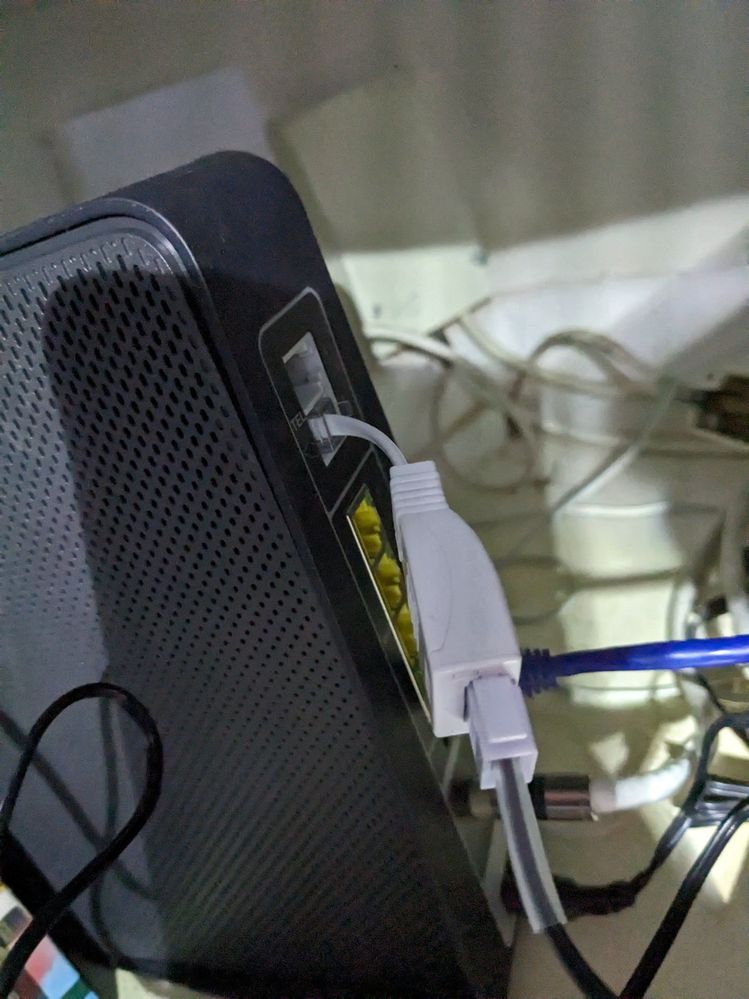

Received adapter.
Received text saying to switch & re-boot hub.
I've plugged the adapter into the Hub & plugged the phone into the adapter. Rebooted the Hub (3.0), Hub status says "Telephony (ready)" but I can't make or receive calls.
What do I do now?

  • No dial tone on the old wall socket. I tried an old non-cordless phone in the wall socket and although there was no dial tone the phone was powered enough to generate tones when the numbers were pressed. When I plug it into the hub I don't even get that. Does it matter which of the 2 "tel" sockets on the hub I use? (I assume I should be using those and not one of the 4 network sockets)

      The Adaptor goes in the top 2 sockets, not all phones may work, how old is the handset you have, you can find out more here.

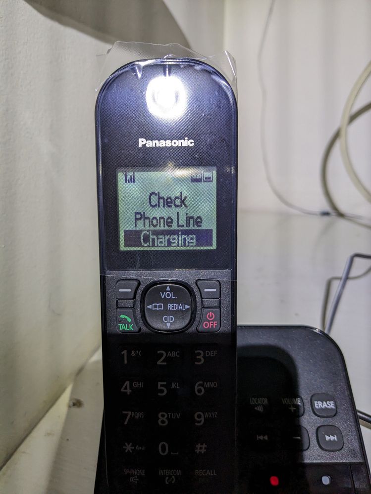

  • So I've just gone out and spent £40 on a Panasonic KX-TGC422. Plugged it in and its saying "check phone line" on the handset screen. Still unable to make calls. I've checked the connections (adapter into hub, phone line into adapter and phone line into handset base-station) and everything is plugged in securely. What now?

  • Thanks for sending the technician. Issue was that the adapter needs to be plugged into the TOP telephone socket - port 1 (The 2nd socket is only if you have a 2nd phone number/line). I missed that small but important detail on the instructions. I assumed it was like a network socket so didn't matter.
