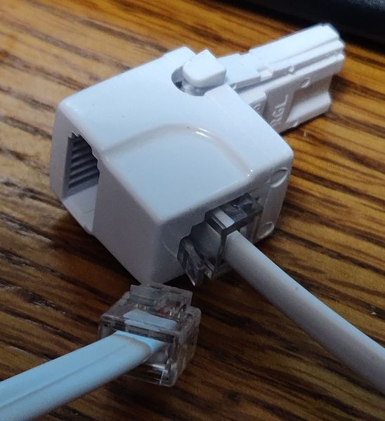

    • goslow's avatar
      goslow
      It should be possible on many modern cordless phones to control the functions of the answering machine from a satellite handset.
      Many models offer a 'message waiting' feature (a flashing light on icon on the display) which can show on the satellite handset or some will make a beeping sound on the satellite handset if there is a message waiting. It should also be possible to control answer phone features, message playback etc. from the satellite handset. This all depends on what model of phone you have as to what exactly it can do.
      Alternatively, if that is no use and if you don't mind running in extra phone cable, VM should be able to fit a phone socket next to the hub location upstairs. From there they should be able to run some phone cable following the same route as the coax cable for the hub along the same path all the way to the omnibox outside.
      In the omnibox they should be able to link the new phone wiring to the existing phone wiring.
      We have seen past topics where VM has then used an adapter lead to back-feed the phone socket connection from the hub into the new telephone wall socket so making all of the existing sockets live via the hub's phone connection.
      It's a bit of a kludge solution but it seems that's what VM offers. We have seen many topics where some of the tech's VM sends out have no idea how to do this so the customer has had to have several visits before the 'right' kind of tech turned up who knew what to do!
      Pic of the adapter lead posted below (which will appear when moderated).
