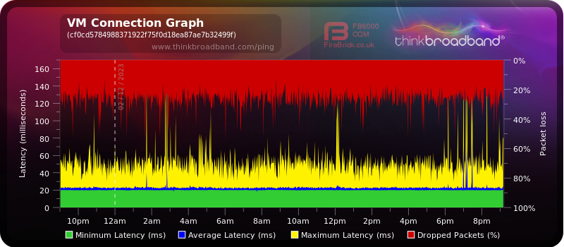

Here is an image of my BroadBand Quality Monitor (BQM) graph (facilitated by ThinkBroadband.com), for the last 24 hours (29 Nov, circa 0500 to 30 Nov, circa 0500).
As you can see here, performance of the connection is quite alarming.  I am getting a lot of packet loss, and a lot of latency.

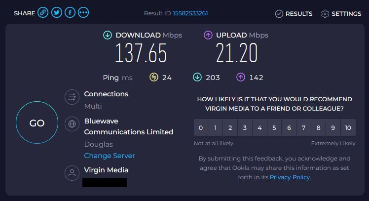

    SpeedTest.net usually gives me surprisingly good results, after I make some re-attempts, should it fail on the first try.  Personally, I feel it fails to recognise the problems I am having when it comes to "everyday connection reliability", and in particular, packet loss and latency (which ThinkBroadband.com's Broadband Quality Monitor reveals much better.)
    Here is my last test result for my current M125 service (02/12/23 at circa 1900hrs):

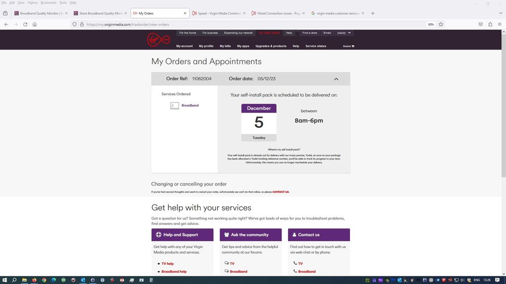

        One thing: at time of writing (circa 1325hrs, 03/12/23) the appointment is not yet showing on my "My Virgin Media" account page, under the "Orders and Appointments" quick-link.  To illustrate, here is a pic of my "Orders and Appointments" page at the moment (it just shows the upcoming Hub delivery [only] at this point):
        I'm hopeful it will update soon!  I will continue to check on there throughout the day, and hopefully it will appear.

  • Some more data!  🙂
    Hope this is useful to some of the experts on here!
    PART 1:  24 Hour Broadband Quality Monitor (BQM) -- circa 2100 01/12/23 to circa 2100 02/12/23:
    Again, my BQM results remain pretty alarming.  Lots of dropped packets and latency.

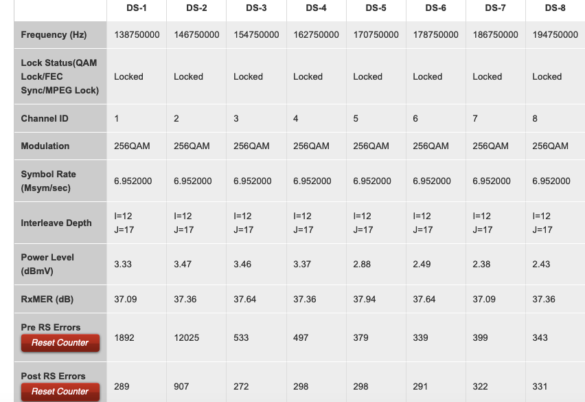

    PART 2:  Hub 2 Diagnostic Info -- Collected 02/12/23 at circa 2130
    This time, I have logged into my Hub 2 at http://192.168.0.1, then have taken all the info from the "Router Status" link (at the top-right for the Hub 2), without actually fully logging in (to the password protected section).
    Last "pinhole reset" was, as far as I can recall, on 30/11/23 at circa 0645.

    From my non-expert understanding, I feel that the amount of Pre RS Errors and Post RS Errors I am accumulating is concerning.

      Pre errors are usually ok. It's post errors which are bad. You shouldn't have any at all. This indicates an issue with your connection. Having a super hub 2 shows the age of the set up also
      You 100% need a field technician out asap, the hub change alone will not resolve it
      • jbrennand's avatar
        jbrennand
        I bet you 50p - you will get a Hub3 😎
        I had an SH2 for many years and it always showed many and increasing PostRS errors (see below for an old screenshot)  - but I NEVER had any VM connection problems at all.   Reset the errors to 0 and see how quickly they accumulate.
        That said,  I personally would never use any ISP hub other than in modem only mode 👍
        I spoke with a VM tech a few years ago on a visit - who said that... it was just a normal "feature" of how the SH2 connected to the network... and accumulation of a few hundred PostRS errors was absolutely normal for that particular Hub when it connects to the network.  Hub3/4/5's connect differently and these errors should be 0 on the newer Hubs.  I have no reason to doubt that information.

    John when a BQM looks like what it is their is nothing wrong with the customers equipment to VM network it is VM network be it docsis or routing the way you can tell is ping does not spike high but shows constant packet loss and its more true if they use the hub in router mode.

    There was one final thing that I wonder if a member of the VM Forum Team can help me with.
    Currently, I have an engineer/technician appointment booked on a day where I cannot get the day off work.  It's for Thu 7 Dec, 0800-1300.
    If at all possible, could I liase with someone via DM/Private Message to get an alternative appointment booked?
    I can do any of the following:
    (1) Any Saturday/Sunday (any time of day), except Sat 16th or Sun 17th (as I am working these days!)
    (2) Thu 14th Dec (any time of day).  (This is a rare week-day off work for me!)
    (3) Tue 19th Dec (any time of day).  (This is a rare week-day off work for me!)
    (4) If the worst comes to the worst, Wed 3rd Jan (any time of day), Thu 4th Jan (any time of day), or Fri 5th of Jan (any time of day).  (That would be quite a long wait though!)
    Reason I ask is that the current appointment is not showing on my "My Virgin Media" account page, under the "Orders and Appointments" quick-link.  So, I cannot change it online.

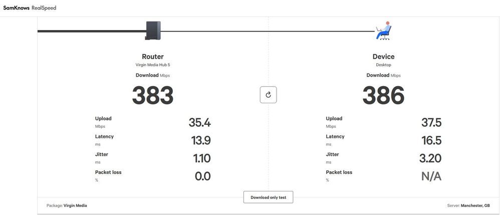

  • Quick update (10/12/23):
    I have ran some more SamKnows "Real Speed" Tests, at https://samknows.com/realspeed/
    Under my new M350 service, speed (in Mbps) to my desktop machine also seems to have sorted itself out.
    As we can see, the speed attained is roughly in balance, over the Hub 5, and the desktop machine.
    Not sure why, but I'll take that result!  🙂
    Tests:
    SamKnows Real Speed Test -- 10/12/23 (A)
    SamKnows Real Speed Test -- 10/12/23 (B)
    Thanks again to everyone who has helped me out.  I really appreciated your input and help folks.  🙂
