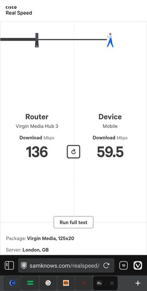

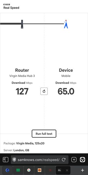

WiFi Speed is fluctuating.
Recently switched from 70mbps to Virgin 125. Noticed that the WiFi speed fluctuates a lot. I have done some speed test on my phone in the same place within minutes apart and it changes a lot I think. When I was streaming with BT on 70mbps my tv never buffered but it is buffering with Virgin's supposedly faster broadband. Is this normal or there is something wrong?

    It would be super helpful if you could select "Full test"
    so we see the Upstream speed, the Jitter, Latency and Packet loss
    for the Hub and also for your mobile Wi-Fi device.
    But looking at the results we see, the last test run shows the speed to the Hub being normal,
    the group of tests suggest that the Wi-Fi device might not be going any faster because it is connected on the 2.4 GHz band.
    Some older laptops and mobiles like the Samsung A12 don't support 5GHz Wi-Fi
    so mid 50 Mb/s is about their limit, but that is more than plenty for reliable operation.
