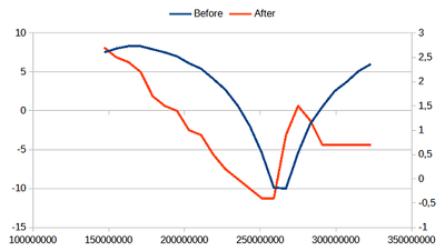

I recently noticed a bit of lag now and again with my Hub 3, and I decided to check the stats on it and found that there's a bit of a discrepancy regarding the power levels of downstream - is it normal for some channels have very negative power and others positive power ?
There's also quite a lot of post-RS errors on those channels which have a more extreme power values.
Please could you let me know if this is an issue with my line, or I can do something else to improve this, or does this need an engineer visit? Thank you!
