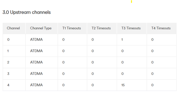

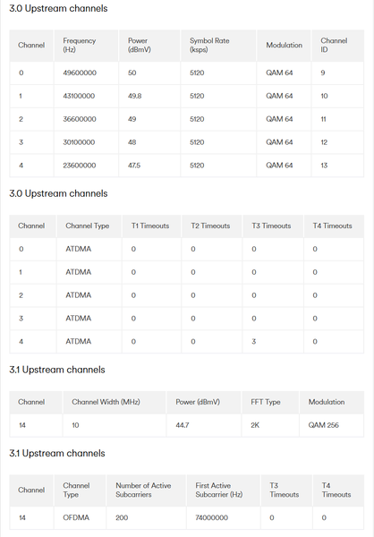

    For a while after this I kept seeing upload speed degredation after some days of the router being online. It would drop from around 104 to 90 then to 80 and below, and would only be fixed after a restart. This also came with a noticeable spike in noise on the BQM, which would also immediately settle after a restart. I noticed over the last couple of weeks that this stopped happening and then today I noticed I finally have a DOCSIS 3.1 upload channel....weird. I guess VM have done some work externally that has finally given me a 3.1 upstream channel. However I still see consistent T3 timeouts on upload, there is always at least one T3 timeout on this page:
    Connection seems fine though so I guess I just ignore these timeouts?

        Hi Alex,
        Thanks for checking, the connection seems to be OK but I now have 16 T3 timeouts...just not sure if this is normal?
