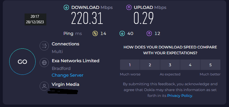

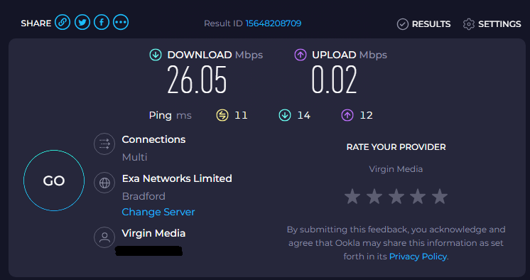

Unstable patchy speeds with no upload speed.
I have absolute 0 upload speed & a wide range of download speeds that just seems to stop since Saturday morning.
I've checked all cabling even though I've not touched it for weeks. I've gone to Virgins site & did the check & it came back saying there's an issue in my postcode that's effecting my broadband service. Engineers are aware & currently trying to resolve the problem & to check back later for updates. Well, I'm now on my 4th day with no internet because it's not usable at all. Which means I have no TV, because I get my TV service through my broadband. I have no streaming services, I can barely get this forum to load.

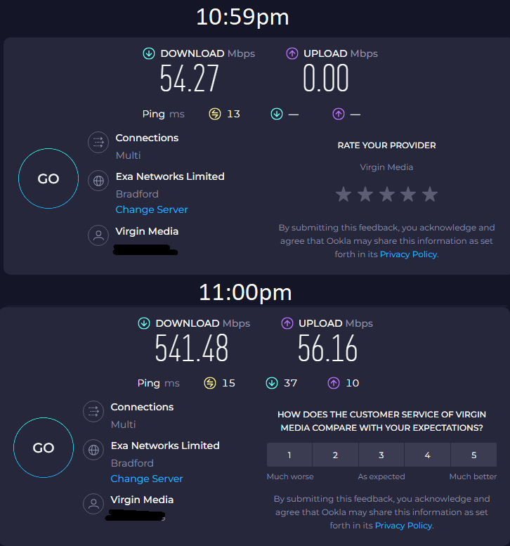

What I find odd, everything was working perfectly up until 8:30am on Saturday morning, but everything went back to working perfectly at exactly 11pm. And it did it again on Sunday, Monday & today. Why is this problem happening between 8:30am & 11pm each day? I just don't get why it seems to start & then stop exactly at those times each day. Makes me think my service is being throttled to make room for others & if so I'm done. I'm sorry but this close to Christmas with kids at home end of the week for 2 weeks amongst everything else, it's not acceptable at all.
This is what I've had to put up with for 4 days now & I've been told nothing of when this will be fixed. I'm disgusted with the service & I can't even get though to customer services because I keep being told engineers are working on it.

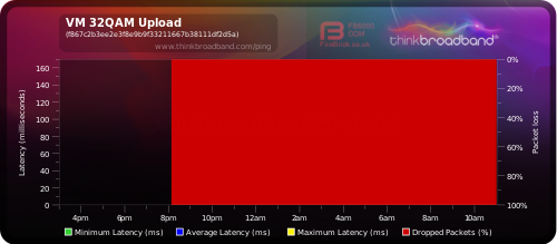

Upstream bonded channels
14960000040512032 qam9
22360000040512032 qam13
33010000040512032 qam12
43660000039.8512032 qam11
54310000040512032 qam10
1ATDMA0000
2ATDMA0030
3ATDMA005102
4ATDMA0020
5ATDMA0000
