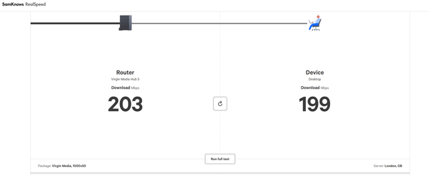

i upgraded to the 1Gig package from my previous 350meg in Feb of 2024 along with this they also upgraded the hub from the hub3 to the hub5. Initially it was all fine for a while the hub was receiving the 1Gig speed coming into the home according to samknows/realspeed checker - then from September 2024 onwards the hub itself is not receiving anywhere near to that sort of speed. please see screenshot below - did this check while writing this post.
i always get around 200 average coming into the hub5 for whatever reason. Virgin Media engineers have been out to my home on several occasions since this issue has started - i have had 6 visits so far till date and they still cant fix this speed issue.

    Welcome back to the Community and thanks for taking the time to post. I’m sorry to hear of the issues that you’re having with your connection at the moment. I've been able to locate you on our system and have ran some checks on your connection, we'll need to send an engineer out to your home to resolve the issues with the SNR(Signal to Noise Ratio) levels of your connection. The levels are too low to be able to run a stable connection, so we'd need an engineer visit arranging to fix the issues.
    I can arrange the appointment from here but would need to confirm a few details via a private message, that I will drop over in a moment. Please look out for the private message and we can get started.

      in terms of what you are suggesting with it being issues with the SNR - this has been on going since September 2024 onwards with several engineer visits and none of them have still been able to resolve this speed issue - surely someone would have picked up on this by now

        Thanks for letting me know officiallysam, please see my latest response. Also we cannot tell when the SNR issues on your account rather than in the local area actually started, so there could have been another issue on the previous visits. The live system was showing an SNR issue when I replied last Monday.
