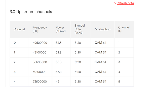

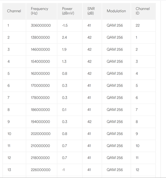

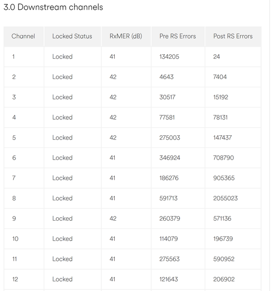

    Just to update here are few details from the Hub 5 signal levels, Upstream, Downstream and why is there a ton of post RS Errors? Is this normal?
  • The upstream power levels are too high, and a large number of 'Post RS Errors' on the downstream.
