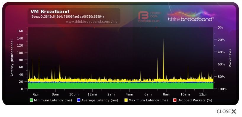

        Will take 24h to develop the full picture... post back when you have that image (black out the  ip address).
  • Hi,
    The monitor has been running for around 22 hours, it has generated date but I have no idea what this means.
    • jbrennand's avatar
      jbrennand
      OK no evidence of overutiliastion in your area - otherwise it would look like this....
      https://community.virginmedia.com/t5/Forum-Archive/Jitter-and-latency/m-p/4609932#M378967
      So its probable the issue is due to something specific to you (or a few users)  So to start to pin that down can you say whether your issues are only evident on wifi connections - or do you see them at the same times on devices connected on ethernet cables? If you don't know, can you check on one to help diagnose whether it is just a wifi issue or it could be network connection/Hub related?
