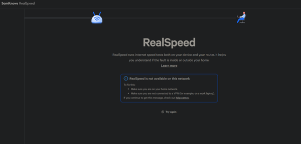

Hello, I can't seem to get the sam knows real speed to work at all! My PC is connected to the modem through ethernet cable and I keep getting this. Reason I'm doing this is because I have a 1GB package and other speed test sites shows I'm only getting half... virgin won't accept other speed test websites and to use this website. Please any advice on how to fix this is appreciated!

    Samknows Realspeed requires :
    1) The VM Hub is in Router mode.
    2) No use of VPNs / Private Relays / Antivirus Packages that contain a web proxy.
    There are also Samknows Realspeed apps for Android and iPhone.
    Again these require no VPNs or Android DNS changer apps / Apple Private Relay.

      Thank you for getting back to me. Im on none of the above and still get the same issue. Ive tried it on my phone as well and still same message.

        If both not using a VPN, did you click on the 'help centre' on the error message?
        That should help fix this :)

    I also get this on a work PC due to using a VPN - if you're using a VPN please remove it and try again :)

      RealSpeed is not yet configured for this router
      We cannot currently run RealSpeed on this router.
      seems to be an issue with mine. as this is the message i get.
