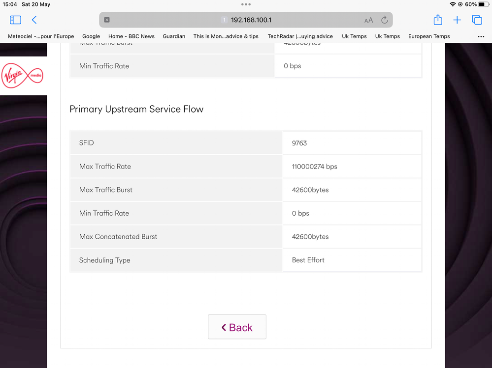

- CawsieUp to speed
- CawsieUp to speed
Looks like i had the 100 mbps upload after a reboot. Noticed my upload qam still at 64. Is this normal?
