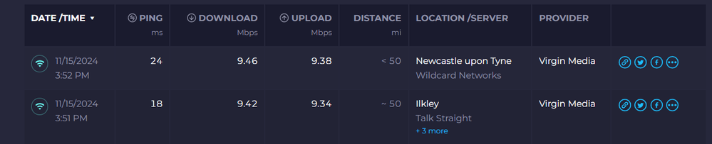

Hi.
I've recently had an issue with red light on my Hub 3 (https://community.virginmedia.com/t5/Networking-and-WiFi/Red-light-on-Hub-3/m-p/5589402#M599039) which has been solved by an engineer visit this afternoon who's changed the hub for another Hub 3.
My contract with VM is for M250 broadband but the speeds I'm getting from this hub are particularly slow. Instead of the 200-250Mbs I was getting with the old hub, this new one is giving me 9.4 which is drastically short. Is this normal with a new hub - slow to start but will pick up later, or should the speed instantly be the same as before as I'm thinking?
The test has been done at Speedtest.net where I usually go and my PC is wired to the hub.
Thanks!

  • Considering you are seeing around 9.x Mbps up and down, and you should be seeing 250Mbps down / 25Mbps up, I'd suggest your PC has negotiated at 10Mbps instead of 1Gbps.

      I've had to Google what you meant and through that I've check the cables the virgin guy plugged back in (which embarrassingly I never thought to do in the first place), when he changed the box. Checking https://samknows.com/realspeed/  (thanks @newapollo) I've found the speed coming into the house is what I'm supposed to be getting but the speed between the hub and my PC was showing at 10Mbps. I've checked the ethernet at the hub which I found was tight, and plugged it into a different port where the cable has a bit more room. Instantly the speed to my PC has shot up to 276Mbps! I'll keep an eye on it for the next day or so to make sure its fine and dandy.
