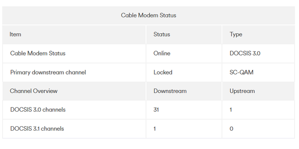

Recently upgraded to 1gbps, upload was good for a day, now only 25mbps with one upload channel
As per the title we were upgraded to a 1Gig connection last week and also given a new Hub 5 router. I switched it out on Thursday and day one everything was fine. I was getting ~950Mbps download, 105Mbps upload. Then early morning on day two the internet went off entirely a couple of times, and ever since coming back on whilst the download remains good, the upload has been cut to 20-25Mbps.

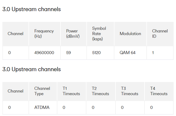

Had a look at the router config and can see what must be the reason why, only one upload 3.0 channel. Max traffic rate for upload is set at 110000274 bps so that is correct.
There are a few critical errors on the log
SYNC Timing Synchronization failure - Failed to acquire QAM/QPSK symbol timing
SYNC Timing Synchronization failure - Loss of Sync
Started Unicast Maintenance Ranging - No Response received - T3 time-out;
16 consecutive T3 timeouts while trying to range on upstream channel 3
I have turned it off/on again a few times, checked all the connections, still the same.

  • I’ve been dealing with a very similar issue — high upstream power, frequent log errors, and upstream DOCSIS 3.1 not functioning properly. My upload dropped significantly too. VM support kept insisting it was my internal setup or the hub, it’s become clear this is likely signal or cabinet-side.  You’re not alone — here’s my thread if it helps for comparison Hub 5 stuck on DOCSIS 3.0 – Ranging Failures, High Upstream Power, DOCSIS 3.1 Not Engaging | Virgin Media Community - 5652510

    3.0 Upstream Power Levels of 35 to 49 dBmV are preferred, with QAM 64 Modulation mode across all four to six DOCSIS 3.0 channels.  Seeing QAM 32/16/QPSK is a current service noise fault.  Seeing less than four DOCSIS 3.0 channels is usually a signal level fault.

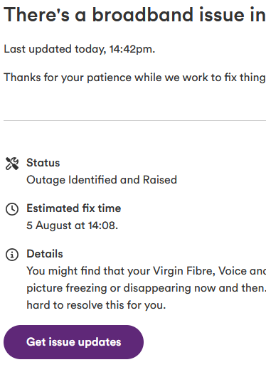

  • This issue remains on and off and it does seem to be a local issue. The frustrating thing though is at least three times now I've gone on service status, they say there is an intermittent fault and I sign up for updates. A couple of days pass, they claim an engineer has been out and the issue is now fixed. But it's not. A few hours later, service status says the same and I can sign up for a new update. Rinse and repeat.
    F011920325
    F011926060
    F011934963

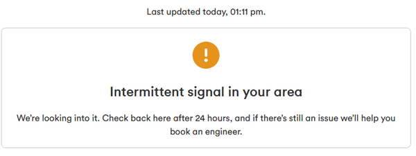

    Those are the three fault IDs they claim to have found and fixed since July 23. I haven't seen anyone in my road, nor the surrounding roads. That last one they claim to have fixed 10 minutes ago, 1pm, yet what a surprise:
     Is their fault tracking just made up? What do I need to do for them to ACTUALLY fix it? There is never a link to book an engineer after the 24 hours. Just the option to get updates on their "fix".
  • ..and the cycle continues. Time to get updates for the fourth issue they've found and will surely "fix" again.
  • Yes, big surprise. They email me this morning claiming an engineer has been out and good news, they've fixed the issue....again. Yet in reality my issue remains and the service status page starts the loop again of saying there is an intermittent issue in the area that they'll be out to fix soon.
    This really is rather frustrating.

        Two weeks on and yes, still the same issues are reported on the service status.
        Intermittent signal in your area
        We’re looking into it. Check back here after 2 hours, and if there’s still an issue we’ll help you book an engineer.
        But I never get the option to book an engineer. Let's see if I do in 2 hours. Speeds are a little better, but still only about 60Mbps upload, not 100Mbps.
