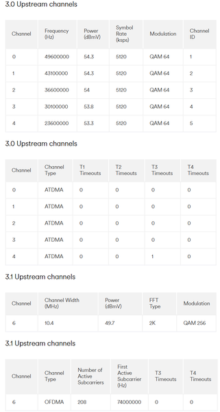

Power Levels out of range?
Hi, I've had the Gig1 service for just over 2 weeks now and don't seem to be able to get over 300 when doing speed tests so I did a bit of research and I think my upstream power levels are out of range. Could someone check this and confirm please? Thank you.
These are my downstream levels
3.0 Downstream channels

  • Yup upstream power levels look too high and downstream are on the low side. Lots of post RS errors too. Check for local faults on 0800 561 0061.
    • Dean333's avatar
      Dean333
      Thanks, I've phoned that number and it said no faults. So I'm guessing I need an engineer to come out?
