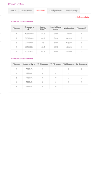

Poor upload,packet loss, intermittent signal
This started just after jan,had an engineer out replaced the coax cable ,cleared some noise of the line ,sorted the issue for about 2 weeks ,then suddenly 9th feb it went again.

    I think i found the issue causing my poor upload and packet loss ,one of the bonded upstream channels is only at 16qam ,they should all be at 64 qam
