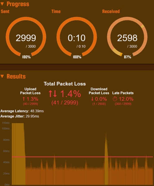

    Run some test to see if its upstream or downstream
    https://packetlosstest.com/
    https://devicetests.com/packet-loss-test
    • Rwilliams100's avatar
      Rwilliams100
      This is what I get. I selected the preset of 1080p stream as this is where im seeing the buffering every now and again.

    When the technician comes, show them the test results you posted here. The fault is not with the downstream levels, the packet loss is on the upstream.
