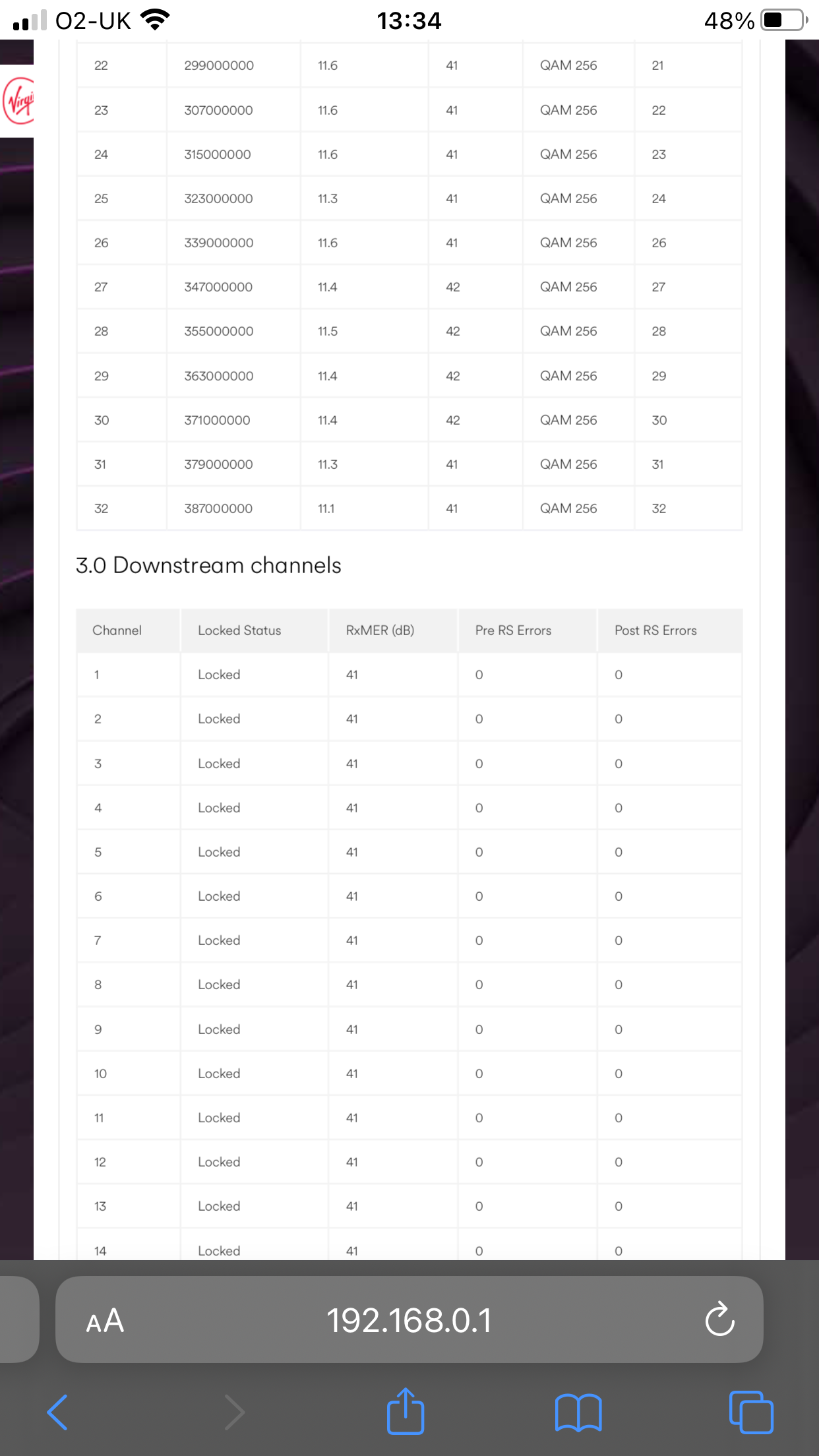

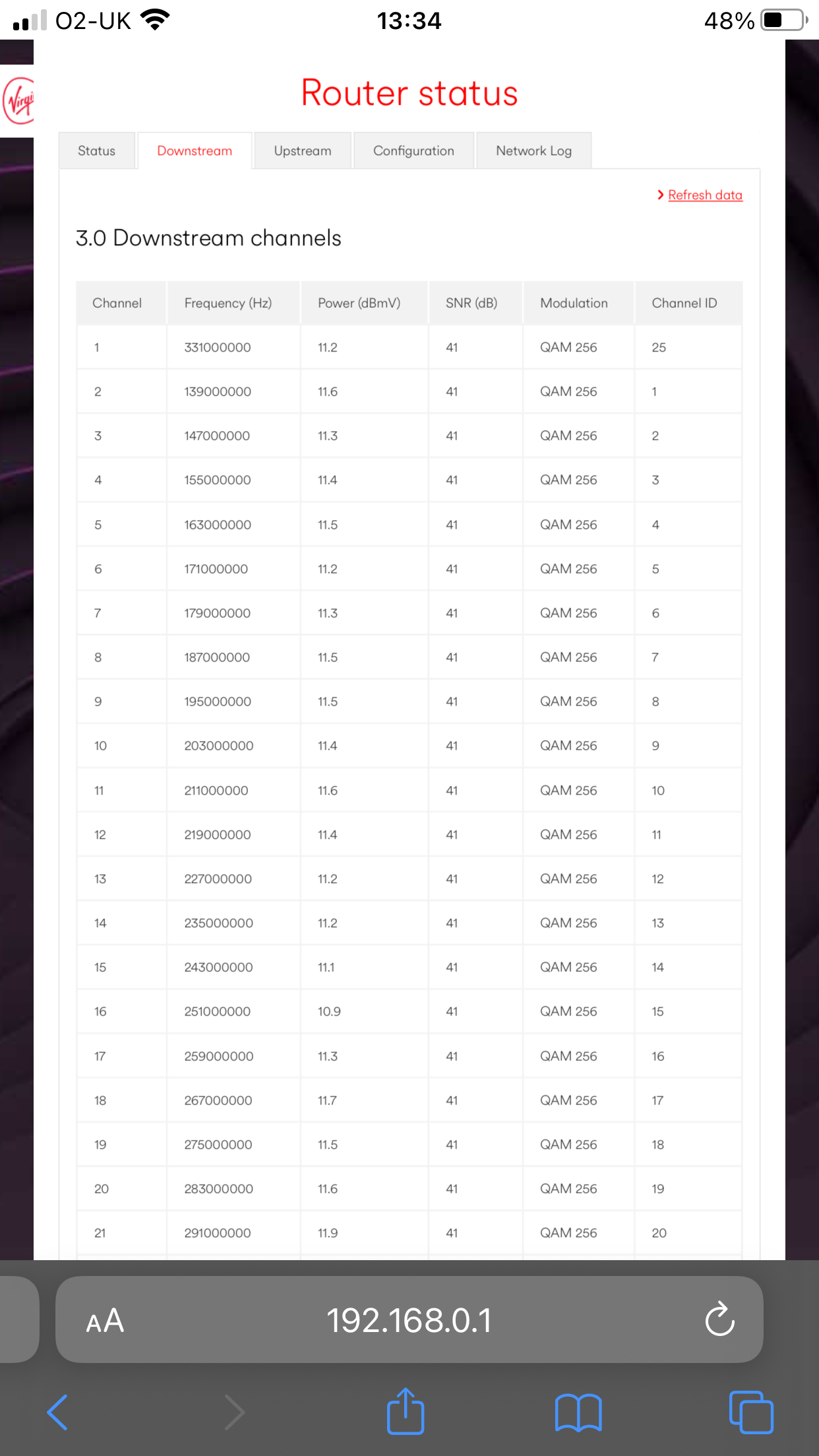

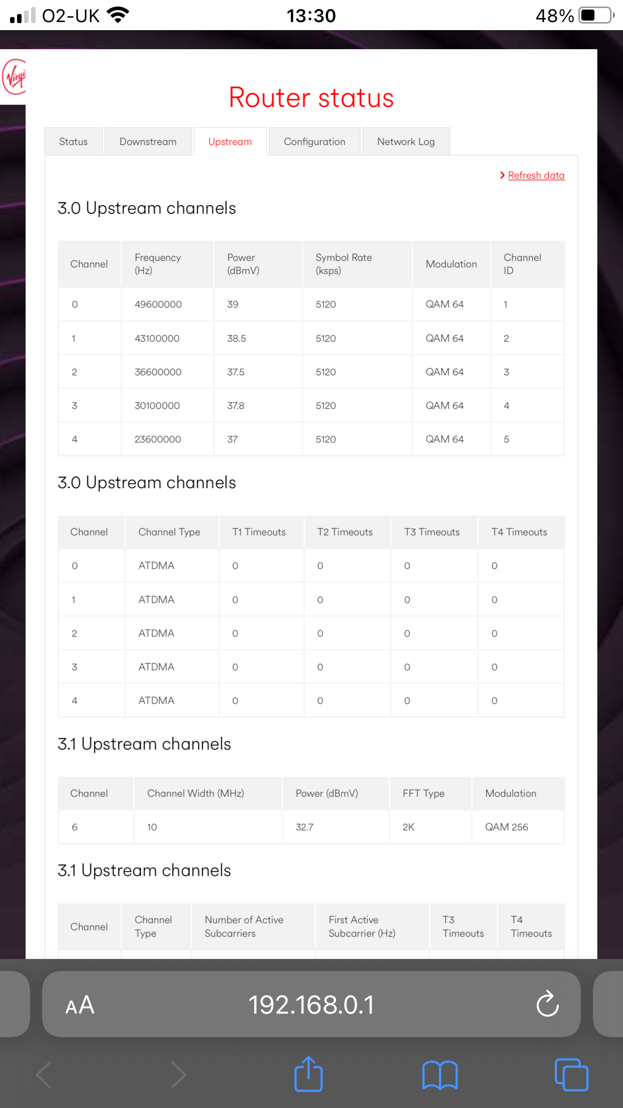

    Post the power levels, Pre and PostRS errors and network log from the Hub. Also setup a BQM to monitor your circuit www.thinkbroadband.com/ping

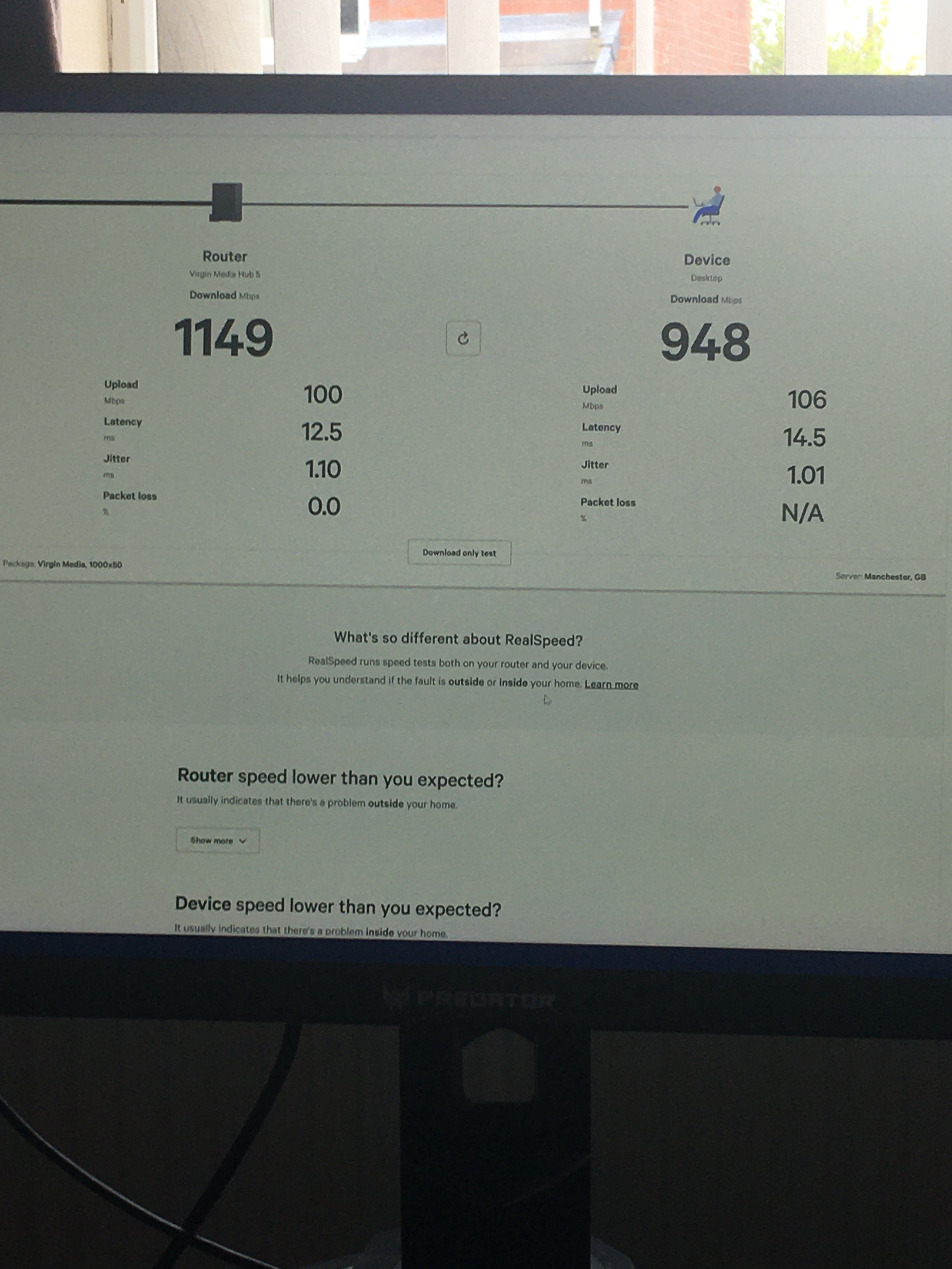

      my wired speed test was when I used my Ethernet cable to connect my pc. I’m not techie so I took a screenshot after doing a full test on samknows:-
      My router log and pre and post errors:-

        You are getting the full 1Gb speed to your PC as shown by SamKnows. If your issue is WiFi that’s a different matter.  VM only guarantee 30Mb over WiFi.
