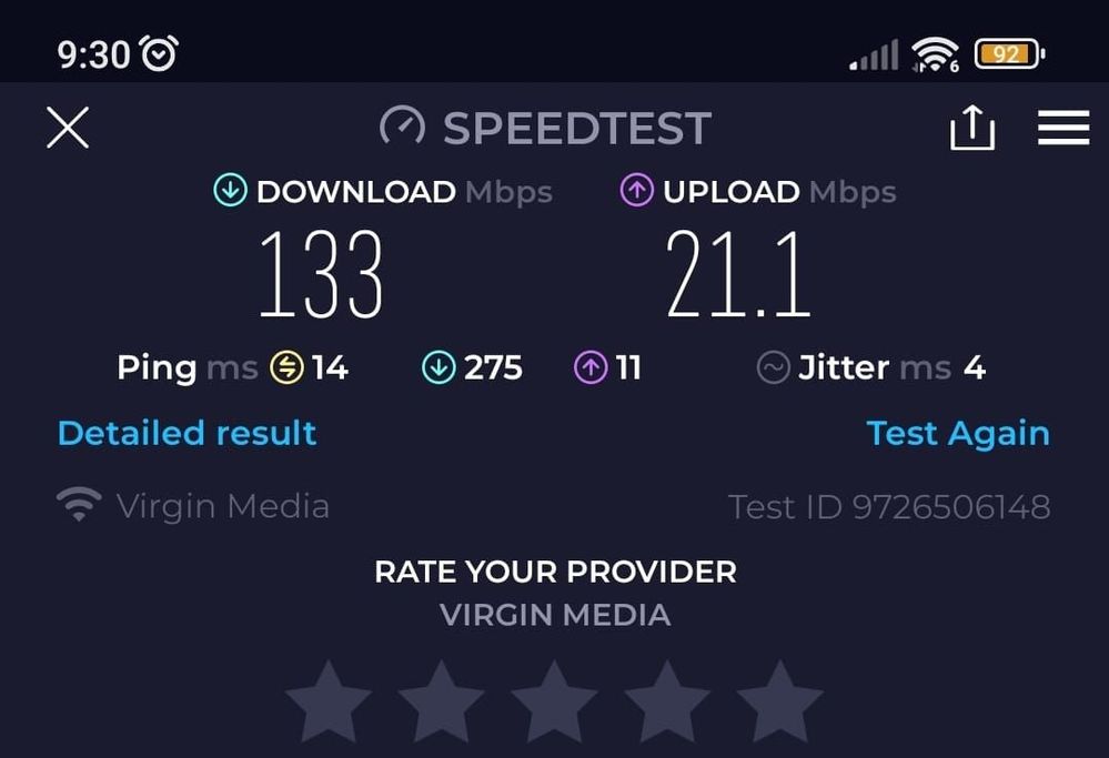

  • You not even getting decent speed for M125. I get this 40ft away from router in the rear extended kitchen through 2 walls.
