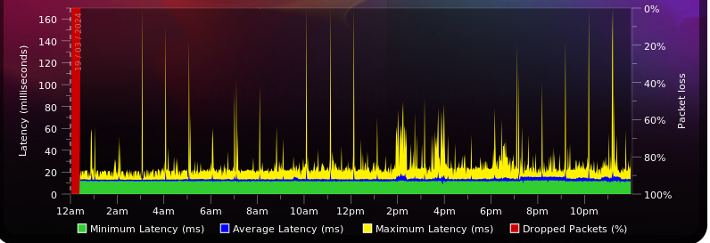

    Also... If you haven’t already, set up a free, secure and “offlsite” - “Broadband Quality Monitor” to continually monitor the state of your connection and record any true network dropouts , latency issues, packet drops, etc -provides a useful graphic output of your latency
    It will also allow you to differentiate between those and simple wifi dropouts. It does it 24/7/365 and it keeps a visual record of any/all of your network disconnections, useful data to have to match to the Network logs (in your Hub settings) and also in discussions with VM - note it will take a few hours to start seeing a sensible picture - post up the “link” to the “share live graph”. Click the lower link (Share Live Graph) then, click generate. Copy the text in the Direct Link box, beware, there may be more text than you can see. On here click the Link icon (2 links chain to the left of the camera icon) In the URL box paste the link you copied and then click OK

    Have you tried the broadband quality monitor as advised in the thread?
    It will help us see where the spikes and drops are in the connection and at what times to identify any trends / patterns.

      Have you set up a BQM as previously mentioned?

    Its not the average latency that kills you it from min to max if far apart that is bad
