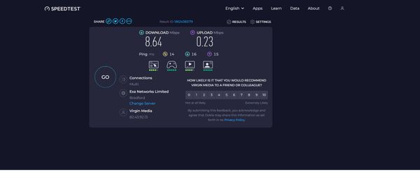

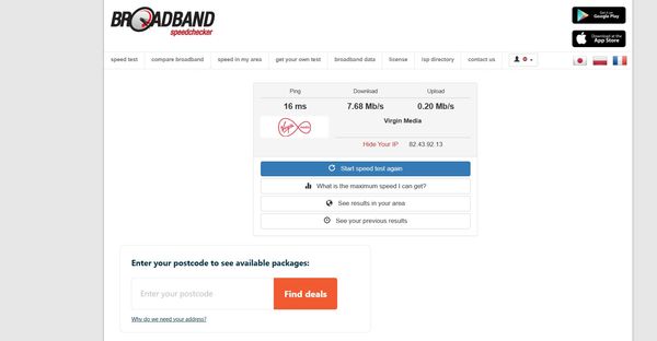

However, this morning it dropped to around 8mbps.  I do a couple of speed tests to confirm (see pics).  I also have the virgin media app and i ran the speed test on that ...and very strangely enough it ran at the same high speed as if there were no problems (ie 132mbps).  I tested at least 3 different speed tests, and all were around 7 or 8mbps except for the Virgin media one which was producing odd results.

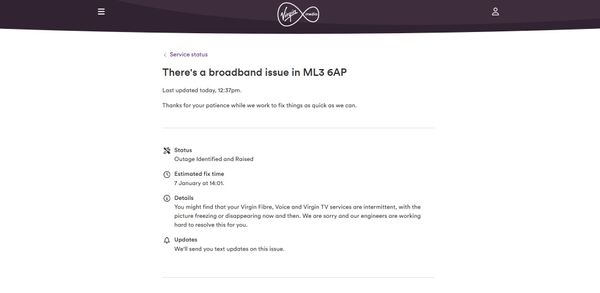

Anyway, i know these things happen no biggie and speed will hopefully go back to normal in a few hours.  My issue is this...when i check for issues in my area which could be causing this the virginmedia app reports that yes there are broadband issues in my area and it won't be properly fixed until 7th January 2026.
So this is an issue for me.  Will you be compensating customers for these issues until the 7th January? i understand there is a minimum speed guarantee and you are part of the ofcom automatic  compensation scheme (though i think that just qualifies if you have total loss of service completely).

    Back down again to 8mbs

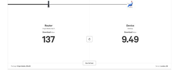

      Your image has been removed but what is the RealSpeed test result to your Router? The previous ones seem to show the speed is fine between the internet and your router but something is wrong between the router and device.
    Run the "official" Samknows speed test, wired if possible.  Run the FULL test as well.  http://www.samknows.com/realspeed
    Post the results please.
    Compensation is due for a total loss of service, after 48 hours.  Not sure how the speed guarantee works though?

    However the minimum speed guarantee does not apply to outages.   The issue in my area is technically classed as an outage.  So i guess the guarantee applies if there is an issue and they cannot figure it out and it is not officially classed as an outage.

      Back today and at 5pm  this is the results from samknows.
  • RusCJ's avatar
    RusCJ
    Managed to run a full test on samknows.
    so from the pc to the router is 137?  ie basically the internal network? And 8.47mbps is external?

    • jpeg1's avatar
      jpeg1
      That means you are getting the correct speed from VM into your Hub. So the drop to 8.47 is between the Hub and your device.
      • cje85's avatar
        cje85
        Wise owl
        Yes, the test shows the Virgin Media connection is fine and exceeding the advertised speed, so it certainly isn't being affected by the fault listed on the status page.
        However, there is something wrong between the hub and the device. What device are you testing on and is it wired or WiFi?

      You need to check using the realspeed site as it doesn't appear to be the connection over the VM network at fault, using the example above.
