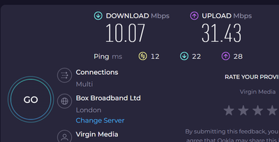

      Thanks, - I remember it was Magenta in the past but checked with all the family and they all think its definitely red now!
      I have BQM which i set up when it started intermittently resetting and having terrible speed issues (also intermittently) BQM Live view
      In the time its taken to logon to the hub and get this info it has reset on me twice - back to flashing yellow\white with green arrows then back to red. That is worse than usual (wondering if logging on to it sent it over the edge) but its been doing that several times a day  for a while.

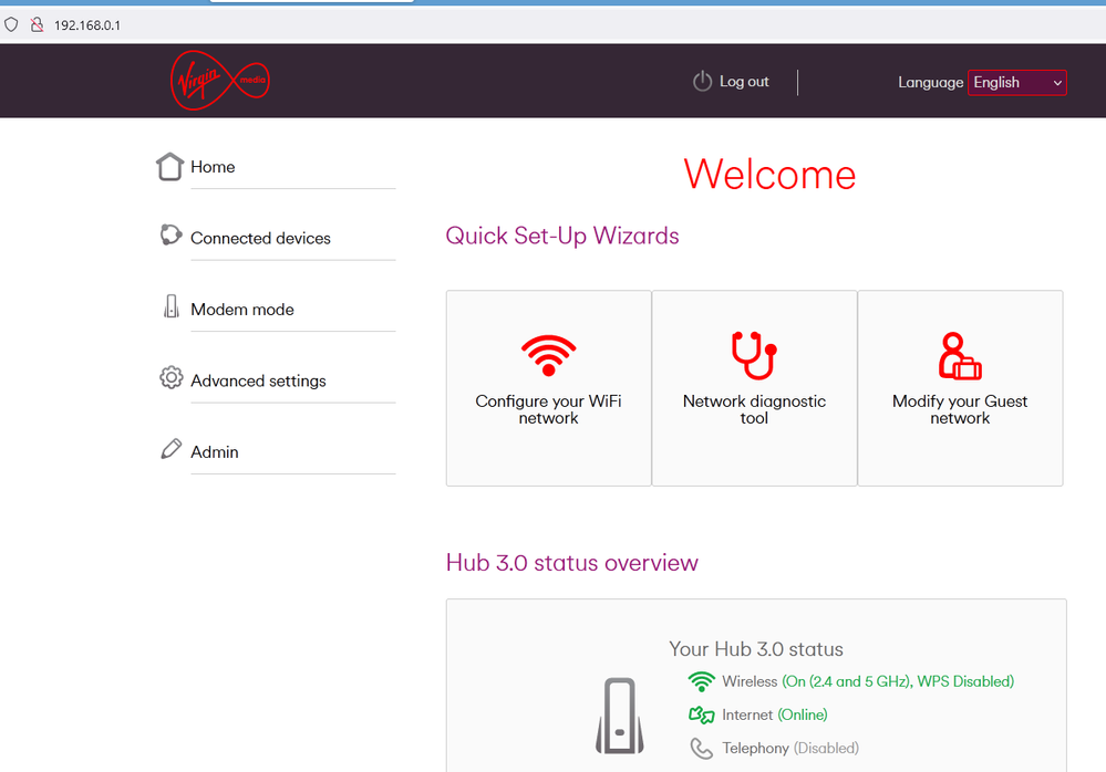

    Check Hub 3 Temperature ... login in to the Hub 3 menu at http://192.168.100.1/   ( for modem mode )
    use the numeric Hub password from the bottom side label.
    Run the Network diagnostic tool
    Scroll down through the results and find the Temperature entry.   Is it:  Normal  ?

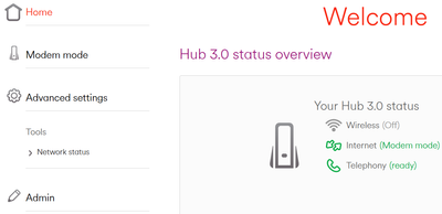

    • rich_simpson's avatar
      rich_simpson
      Thanks - but I cannot find any network diagnostics tool - only network status, which does not have temperature anywhere
      rich_simpson
      ah ok - I guess I have to switch it back to router mode to see that!
      Thanks

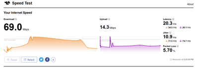

        Ok - now back in router mode - initial results look similar to modem mode at speed.cloudflare.com which show c6% packet loss and speeds well below the 350Mb I used to get (and what my service is supposed to be) but its the packet loss that concerns me I dont see that even a 0.1% loss at all on other networks I use cloudflare on - not even a 4g one. - we'll see if BQM sees any difference.
        (wifi is off and using 1Gb/s Ethernet to the Hub for the below).

      Ok - found it now - have to be in router mode! - It says temperature is normal.
      Thanks

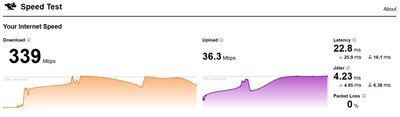

  • Thanks to everyone who took the trouble to respond to my cry for help with advice and to Alex and especially the VM engineer who resolved it today - It tuns out there was a 4 way splitter where the cable comes into the house in the garage which split the cable to my TV box upstairs and router downstairs - It had gone bad somehow - new one of those and all is perfect again with all SNRs at 37 or higher and 0 Post RS errors, no packet loss etc!
    Thanks All!
    what good now looks like
