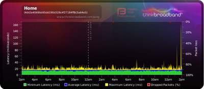

Is this the best place to request an engineer? Hub/BQM doesn't look good.
I recently just upgraded to Gig1 (cable, not full fibre), as I was mainly looking to replace the old router for the newer Hub 5 model. Note that I run the router in modem mode, as I use a home-built OPNsense router/firewall (which the BQM pings to), switch and AP setup. While on 500Mbps for the last year, the BQM has been showing awful spotty dropped packets/downtime, and as the upgrade to 1Gbps was only £4 extra a month, I thought that was worth it for the newer modem in case that was partly the issue.
Alas, the upgrade hasn't made any difference, if anything, I have even more dropped packets. I've never submitted the hub "router status" before, but from others i've compared it to on here, i'm pretty sure something needs to be looked at. Of course, whenever I run the test tool from the VM app/website, nothing comes up as negative, hence me asking here for some feedback.  Note that the BQM from today doesn't actually look that bad, but since the upgrade, I have got the odd dropped packets throughout the day, which never used to be there, instead, I would normally get about an hours downtime around 2pm every day! But still, I thought useful to show regardless.
As for speed, on ethernet, i'm averaging 800/100, but it's the stability of the line i'm more concerned with (I work in IT, sometimes remotely).
Any thoughts/advice would be greatly appreciated!

    Hi demmers
    Have you used the /check-services/  function? You can also a run a test on your equipment from there.
    If nothing is showing  you should also try the automated Service Status number  0800 561 0061.  This often gives details of more local issues down to postcode level.
    Your upstream power levels appear to be high. They should ideally be lower than 51.0

  • jpeg1's avatar
    jpeg1
    Well the first thing that jumps out is that the upstream signal levels are way too high. That may or may not cause your problems, but it certainly needs correcting.
    Also your Hub is working very hard to correct data errors on the downstream channels. It's succeeding at the moment, but it's not a good look.
    You need a technician visit to sort this.
  • Thanks guys, just booked an engineer for Tuesday. Out of interest, will the engineer be able to see these numbers their end too? I'll most probably be out working when they turn up that's all.

  • Tudor's avatar
    Tudor
    Upstream high and downstream log signals either a bad cable somewhere or you need moving to another tap on the street cabinet.
  • Changing from 500Mbps to 1Gig package will not make any difference to your BQM.   As other have said, your modem signals need attention.   If you're on pure coax feed, then ideally you need to be on a 6db higher tap in the street cabinet.  this will improve your DS levels, and cause US to drop by 6db !!
    Modem speed is simply set in the config file (based on your package) that VM downloads to your modem on boot-up. The example below shows what a 990/90 Mbps config would look like in the config file !!
