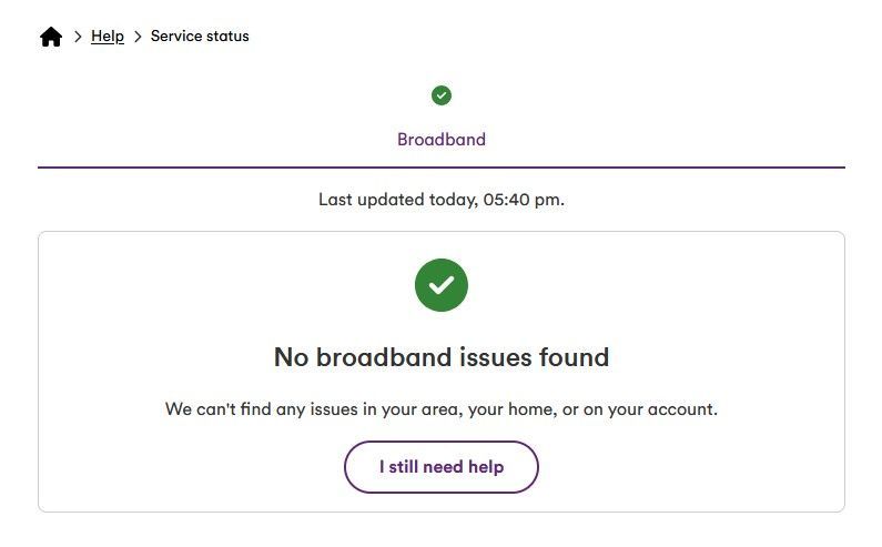

        Thanks for reaching out to us southy1978, and welcome back to our Community Forums!
        Sorry to hear of the recent issues experienced on the connection supplied by Virgin Media.
        Can you confirm if the issue raised is still ongoing?
        When running through a flow on your router, no issues appear to be detected on your connection.
        Thanks
        David_Bn
