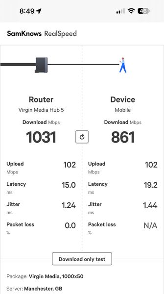

I'm currently on the Gig1 service, which always gives me the full speed of approx 1000-1100Mbps download.
However I'm noticing the upload speed keeps dropping to around 15-20Mbps. I'm able to obtain a 100 upload around 50% of the time. I checked my power levels and logs as per below:

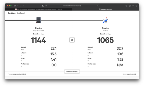

    The issue is still there and the upload speed is still fluctuating a lot. I’m seeing uploads of about 35 this morning to the hub then about 101 this evening  I tested these using SamKnows real speed
    Can you confirm if my statistics and logs from my hub look normal from my original post?

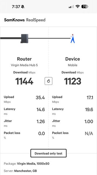

  • And it's dropped again one hour later from the last test which was at 101 upload
    From the Realspeed test, the low Upload speed at the Hub looks like a local service fault.

        This week is much of the same. It's happening at random times, and most of the time, i seem to be getting around 30-40 upload, rather than 100. I'm not using any VPN at all.
        Despite the engineer changing the connection and increasing the power levels slightly, the problem isn't any better. I'm also still getting the log messages in my hub
