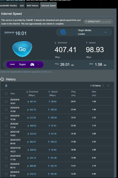

Networking Setup and Issue: I’m experiencing significant speed loss between my Virgin Media Hub and my router.
Here’s what I’ve tested so far: When I plug a wired connection directly into Port 1 on the VM Hub, I get speeds over 1 Gbps, so the external connection appears solid. When I run a speed test through the router, even using a wired connection, I only see about half that speed. Wi-Fi performance is also capped (as expected to some degree), but still lower than it should be.
What I’ve tried: Swapping Ethernet cables (Cat6). Changing ports on both the VM Hub and the router. Rebooting all devices.
Despite all of this, I consistently lose around 50 percent of my available speed between the VM Hub and the router.

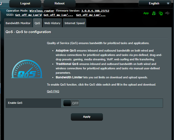

  • QOS is disabled. Yeah I know im not going to be 1Gig but I only get about 50%
    These are from the router to the modem.*
  • You can't get speeds over 1Gbps when using 1Gbps ethernet ports. The maximum is around 940Mbps, so this is the most you'll experince across all devices at the same time when using your HUB 4 in modem mode.
    QOS must be disabled on the Asus.

      QoS isn't what many people think it is*, alas a number of router manufacturers add this 'feature', badly, and cause all sorts of issues. We need to consider what the Asus router might be doing.
      *QoS - Quality of Service, it doesn't prioritise traffic from a particular machine, it doesn't do anything about restricting connection speed (cough, Legacy1, cough), it is concerned with prioritising certain 'classes' of information. VoIP traffic, for example, as long as said packets are properly tagged and the router, in fact no, not the router, the switch, can identify these and push them to the front of the queue! Do you think that the 5p VM hub can do this?
    • dailycanof's avatar
      dailycanof
      I get that I wont get over 1Gig but im only seeing half of that:
      The above shows I'm only getting half, and these tests are done from the router to the modem.
  • legacy1's avatar
    legacy1
    Are you using Asus firmware?
    check your QoS settings try disable the auto stuff might slow your speed
      dailycanof
      my QoS settings are off as far as I can see and still no diff.
