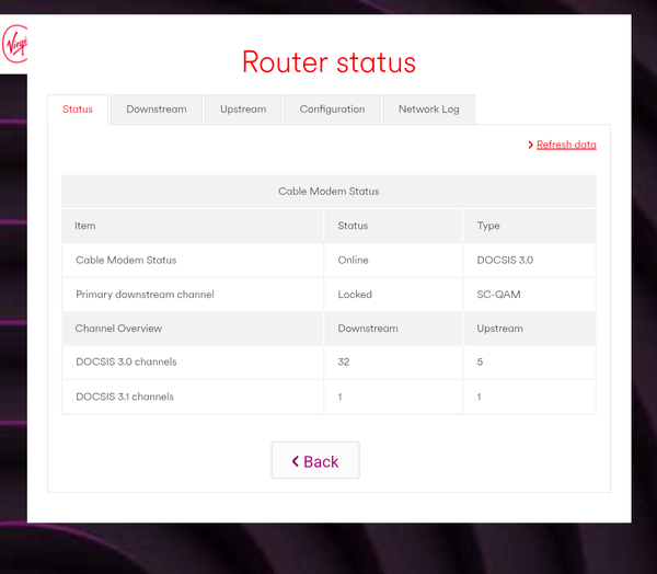

We had new kit installed Mid January - TV360, 2 Stream Boxes and Hub 5. Since installation, we have noticed patchy internet; random short cut outs, and generally slow speeds on and off.
Previously had TV360, TV360 Mini and Hub 4 which was very reliable and consistent speed wise.

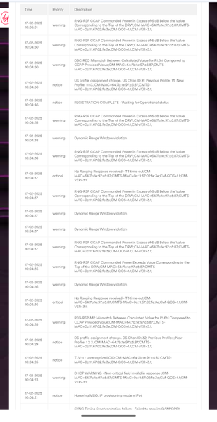

Initially tried ruling out all internal cabling by connecting directly to the primary connection point and utilising only the white TV / Broadband splitter cable provided in the Quick install kit. Still had problems and signal levels / modem errors continued, and so the cable from the street to the house was replaced today, 3 weeks after raising concerns.

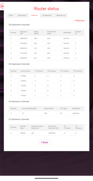

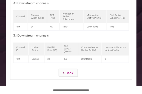

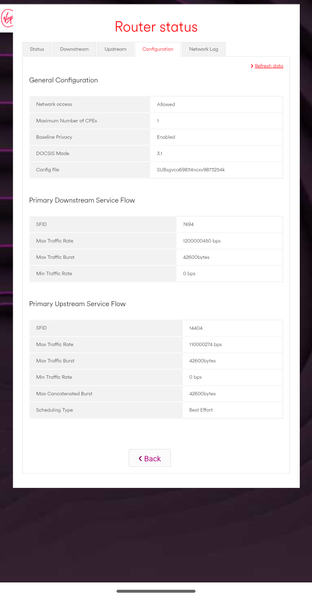

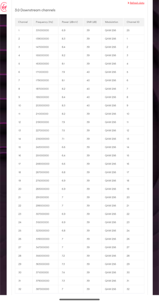

We are still having problems after the new cable was completed this morning, speed tests are hit and miss and not achieving anywhere near Gig1 speeds despite regularly hitting 900+ DL and 100 UL on previous Hub 4 install. Although the minute by minute recurring modem errors appear to have stopped, the Downstream 3.1 levels look on the low side to me and the Upload potentially too high based on what I have read.
Any thoughts appreciated as the QOS monitor I setup doesn't show a lot (assume as the cut outs are so short and speeds aren't monitored).
I will post the modem logs shortly.

      Some of the upstream power levels are too high. Check for local faults on 0800 561 0061. If none are reported call it in as a fault on 0345 454 1111 / 150.
  • Yep, looks like your DOCSIS 3.0 channel's upstream power levels are too high, causing some issues.
    Have you checked for local area issues:

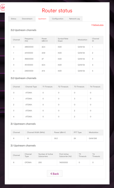

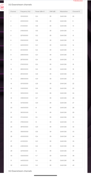

    The tech came yesterday aftwrnoon and was great; listened to what I had to say, had clearly taken a look beforehand and suggested the best solution was to add a HDU to to balance the levels and change the modem out for another to be certain that wasn't the cause.

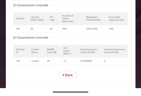

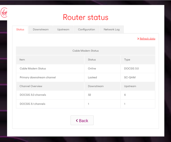

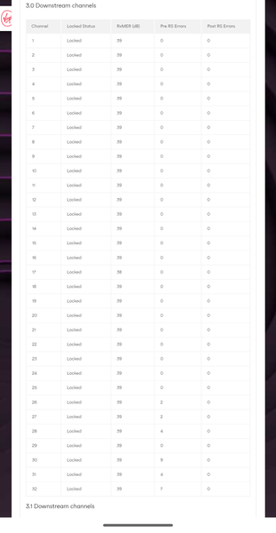

    Since then, the connection still feels patchy, whether it is general browsing (random slow responses and page loading) or for streaming and even sp ed test results are hit and miss. Most notably, I would say the consistency of upload test results has improved, but download now seems speed tests are consistently slower than they were. I also note the uncorrectable errors have slowly started to build again.
    Although the upstream levels now look [mostly] better, are the downstream levels now too high? Do I need to refer this back again for a network technician to get involved?

      Yup all downstream power levels are too high and one 3.0 upstream power level is too. You also have some uncorrectable errors. Check for local faults on 0800 561 0061 otherwise call it in as a fault on 0345 454 1111/150.

    Engineer has visited today. Quickly connected his tester up to our modem connection and confirmed clear problems on the line. Went to do some quick checks in the street and identified that it was water ingress into equipment in the street.
    He has escalated it to the network team and said that it could take 24-48 hours to be actioned.
