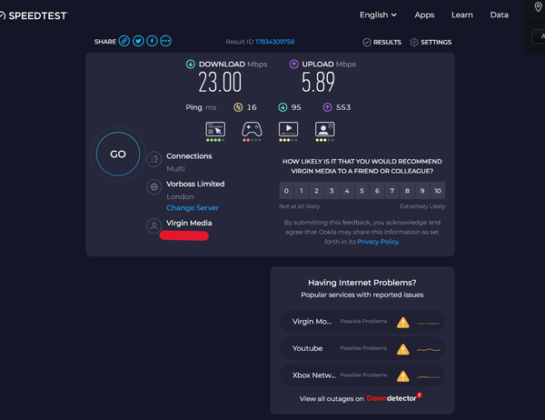

Embarrassingly slow speed
My internet speed the last few weeks has been incredibly slow compared to what it was before. Typically I have been able to break at least 50mb/s on my computer but as of the last few weeks I can barely break 20mb/s with occasional dips to <10mb/s for considerable periods of time.
I have gone through each step typically recommended on the status check website including: resetting the router, changing position and re-plugging. I've even tried alternative methods like changing my DNS IP on the computer to see if that was the issue but to no avail.
If anyone could please look into my router for me I would really appreciate it. I can provide the name account holder and additional details if needed. I will also confirm that this is not an issue with my computer as the Wi-Fi is also very slow even when I'm right next to the router. FYI I use an ethernet cable.
Mod Edit : Image removed

        Hi Daniel, thank you for responding.
        Things are still bad. The Internet is still just as slow as when I posted the screenshot above. We are using the M350 package which, by the standards shown in the link you sent, should get me at least a guaranteed 180mb/s. I've been using a hardwired connection the entire time and the speed is still slow.
        FYI: I made sure to check that many devices weren't hogging all the bandwidth. However, even when home alone and with my computer and phone being the only devices connected to the Internet the speed is still slow spare maybe a +5-10mb/s increase at certain times. If there's anything you can do on your end to check for any issues that would be appreciated.

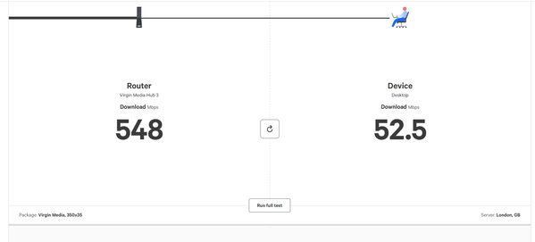

    Samknows Realspeed
    Speed test the service to a Router mode Hub(3/4/5) + your device with the link below.
    Once the test begins click on: Run full test to include: Latency, Jitter, Packet loss & Upload speed
    The speed at the Hub should reflect your subscription.
    Samknows Realspeed is also available as an app for iOS & Android mobiles.

      • PRED_exe's avatar
        PRED_exe
        Here. Sorry I didn't send it before. I am aware that this may be an issue on the part of hardware to the computer. I use the TP-Link TL-PA7017P which is advertised as having up to 1000mbps and a gigabit port. I use the CAT6 cable provided by virgin media for the router to first adapter and a Cat 5e cable from second adapter to PC. I have ordered a new cat 6 cable to use instead of the 5e just in case the cable is faulty and am expecting it on Monday.
        I was not aware of powerline adapters not supporting gigabit speed. I now know they are only half-duplex after doing a little research but I feel like even if they do not support gigabit shouldn't the speed I have still be higher than it is currently? If not then are there other options? Can I request to have the virgin media socket moved to my room or anything? I'm really running out of ideas since there is no way I'm running a cable all the way across my apartment from the router in the living room to my bedroom PC.
