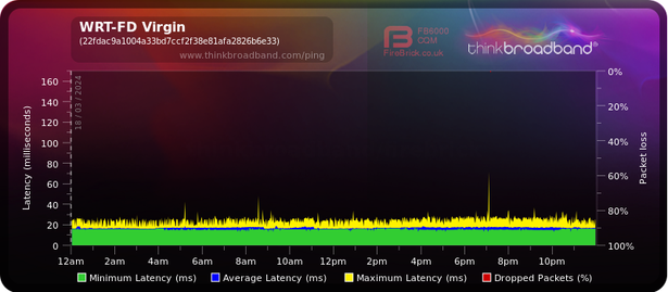

Wondering if there are some congestion issues in Area 14 WF4 this past week or so?
I've generally had a decent performing service until last Sunday when the latency on my connection suddenly jumped up and stays like this for most of the day, with the odd respite back to normal levels here and there during the day.
Whilst the latency spikes, download/upload speeds are affected.
This is an average day prior to last Sunday when I've had no issues:
And this is an average day since the increase in latency last weekend:

  • That graph looks more like your connection being heavily utilised. Anyone running backups, torrents, whatever?

    We have seem BQM like this we don't know the reason best guess is some type of idle state mode thats being enabled in other words its likely upstream where the modem delays sending stuff or the scheduler delays the modem from sending stuff.
