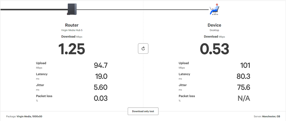

    Given rebooting the VM Hub is not solving the speed issue, perhaps the VM Hub is not the problem.
    Next time you have a speed issue,  find out where the speed is being lost ...
    Test the service to a Router mode Hub(3/4/5/5x) + your device with the link below.
    Once the test begins click on: Run full test to see all the stats.
    The speed at the Hub should reflect your subscription.
    The speed any WiFi device draws data at is limited by its data needs and technical abilities.
  • So it just happened again....
    Rebooting the router solves the issue for a few hours and speeds will be normal then all of a sudden the speed reduces and then I have to reboot the router again?
    Am i going to need an engineer???

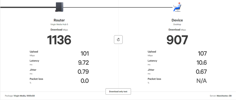

    and this is after i reboot the router :

      Sadly it's showing a few SNR issues on your downstream channels, Which would be the cause.
      I will need to send you a private message to gain account access and arrange for an engineer to attend.
