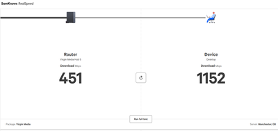

      These are my results from my desktop which is connected via ethernet to the router in the 2.5Gbps slot of the router in Hub 5.0, in router mode.
      I will now change it to modem mode and connect my Asus AX 82U and see what results I get. Wifi and ethernet.
