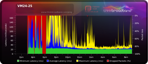

For the past 3 days the broadband performance starts to deteriorate from 8am onwards, becoming unusable by ~2pm, often up until after midnight. I've setup the broadband monitor again to detail the performance:
Running a tracert seems to indicate that the problem appears at the first hop after the router with latencies in excess of 2000ms at its worse.

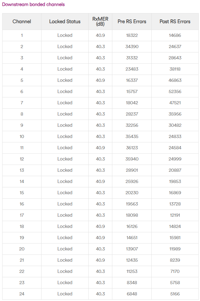

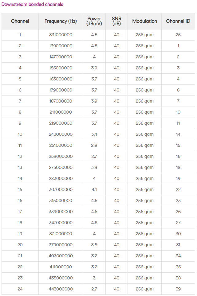

    Check for signal level issues or many errors or lack of connected channels in the Downstream stats of the Hub.
    For a Hub 3 we would expect to see 24 Downstream channels connected at 256 QAM,
    with Power levels between -7 to + 10 dBmV.  and SNR >= 33dB.

      Thanks for responding. Here's what they look like at present:
        Far too many PostRS errors on the circuit.  I would suggest "noise" from an SNR fault on the VM network possibly?  Try checking with Area faults on 0800 561 0061 or if you have a VM landline 150 as small local faults are not listed on the VM status page.
    we didn't experience any complete outages as the graphs suggest: ... can means the wrong IP is in the BQM

      That was my first though, checked and confirmed IP address is correct.

    Reboot router, to clear error stats and then post back after 24 hours to see if those post rs errors are still high. As Adduxi says they are/were horrendous suggesting circuit not fixed!

      Router's been restarted a few time, most recently this morning and the downstream channels look like this:

        Are you personally experiencing any issues after Friday and are you able to share/advise on when they were and for how long? If you're able to share a live link to your BQM we can see this in real-time too, which could be helpful.
    There is still a problem somewhere.  There should be zero (or a very small number) of PostRS errors.  It could be the Hub is faulty, or the cable needs a repull, or a connector is faulty, or a problem in the street cabinet.  Until these errors are fixed, your circuit will continue to struggle.
