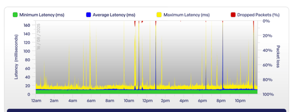

Another thread on packet loss
After moving house in May, our connection in the new house hasn't been good enough, and nothing like it was at the old place.
Several of us in the house work from home, mostly using Teams and Zoom, and a handful of times every day the connection drops for long enough for Teams to freeze and throw the low network quality warning, and you have to repeat the last things that were said!
We're all hard wired so it's not WiFi as we don't have wifi enabled, and we're in modem mode to try and rule out issues with the hub.
My TBB graph on the old connection was virtually flat, with latency well below 10ms.
Customer services of course say there's nothing wrong, and that it must be to do with the wifi.....(which they can't get their heads around that it's not enabled!)
Is there anything in the logs below that I can push back at them, as it's becoming unusable.

    The BQM is not the worst I've seen its unclear if them spikes are caused by you or the upstream in your area bad upstream power a bit high is unclear if that might be a cause.
    Its possible a hub 4 or 5 with Docsis 3.1 channels might help.

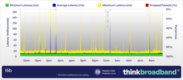

    • df1800's avatar
      df1800
      That is a baseline graph with no traffic on our side, so the spikes are what the connection is doing on its own, but even the slightest packet loss will cause Teams to drop.
      Another example from the 17th, with no traffic on our side with the connection at idle.
      I've tried asking for a Hub 4, but they only want to give it away with the 1gig upgrade, and I'm not upgrading the speed if it's going to be just as unusable.    So far today I've had to tether to my mobile to get through a teams meeting without it constantly freezing.

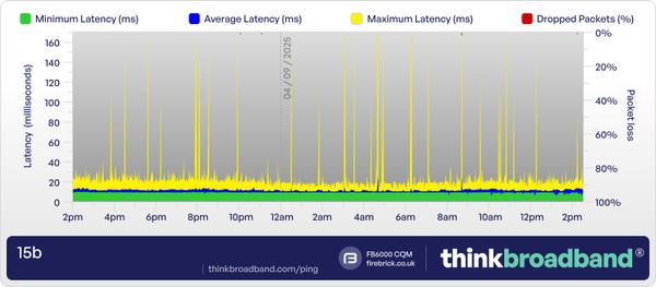

  • OK so engineer visit complete yesterday, so it's been 24hours since new connectors on the cabinet end, and at the boundary of the property as they were both corroded, and he moved us onto a new tap because it was also corroded at the cabinet.
    No need for attenuation, but levels now within spec.
    It's better... but even with virtually no network load our side, it's still very spiky.   I'd hoped some of these peaks would have dropped off.  Todays packet loss just before 9am jammed up my teams call again, so basically no change.

  • A little update on this some time after having an engineer visit to correct the levels.
    It was improved, but has gradually degraded again - back to the point where working from home with regular MS Teams meetings has become almost impossible, and watching TV with this steambox is awful, constantly buffering.
    Using my mobile hotspot, it's fine - so it's definitely the VM connection.  And remember that there's no Wifi enabled - everything is wired with hand made, quality cat6
    I bought that -6db foward path attenuator (yes that was what was being sold) and it made the stability notably worse immediately, so after running a few days, took it off and restarted, and it's back to how it was.  So now that we're two months down the line, an engineer visit, and we're actually no better off.  The peaks are still there, it's still almost unusable, and I've ended up taking a second connection from another provider at great cost (which is noticeably more responsive, and  has a completely flat BQM) Really disappointed.
    Voltages are in spec, Post RS errors aren't especially high, log isn't full of errors other than the usual daily T3 and DHCP field errors.
    Perhaps we now need to look at replacing the cable between the hub and the brown box at the front of the property exterior (where the connector was corroded) or if there is a join somewhere between us and the cabinet which is allowing the interference.
    Either way, it's not good enough.
