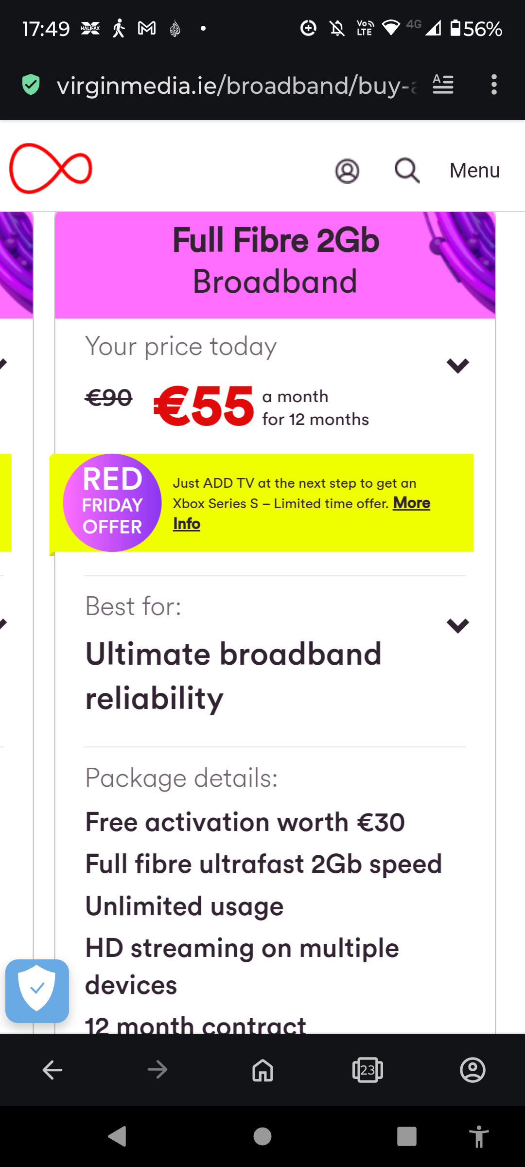

      VM Ireland has been rolling out 2 Gbps for a while (£48*12 then £78).
