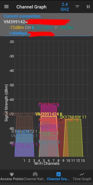

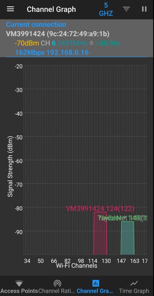

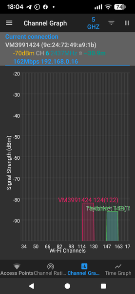

      Looking at those scans, your 5Ghz signal is very poor, it should be over -65dBm for a decent signal.  As for the 2.4Ghz, that's a congested area so not much you can do about that either.  However the plus point is the signal is stronger at -70 dBm, but still not great. Is also not helped by someone using Channel 8!
      Is the Hub in an open area with no interference about it?  Those signal levels are not good really.
      In comparison, I have 3 Wifi access points (Pods in VM speak) and the closest one to me at the moment is -36dBm and the one that is furthest away is -80dBm.
      I don't believe the speed tier would affect the performance of the Wifi antenna's in the Hub, and this just looks like interference or a bad placement.

      I don’t know about that Router. Being for Vodafone it may be locked down and not configurable?  Anyway it may not help, I mean looking at your WiFi analysis you have, by my count, 12 other WiFi signals in your location.  This makes it difficult to get good performance as each WiFi unit has to share the space. I’ve always said a single Router is not always the best solution. It may be better to ditch the Pods and setup a good quality Mesh or Access Points?  However this is not a cheap solution. At least you can manually setup everything to try and avoid WiFi clashes etc.  Not what you want to hear really?
