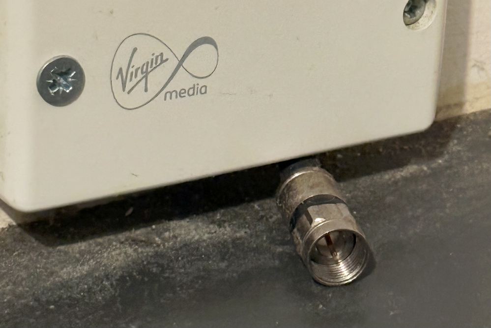

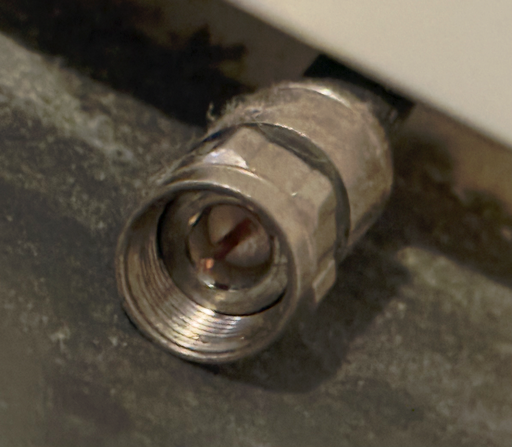

If you have a cable/plug trailing from the wall, you need a coupler adapter to join two plugs together
https://www.diy.com/departments/slx-coaxial-connector-19mm/5028422001905_BQ.prd
Also available from the likes of Screwfix, Homebase, Toolstation etc.

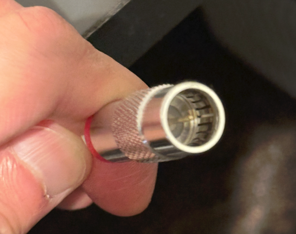

The cable trailing from the wall is screw fit. The cable in your hand is push fit.
- whatisJoining in
Thank you, I’m just not sure if they are the same connector type.
- Client62Alessandro Volta
They are both F-Type. Sadly VM have moved to push fit and these can need a very firm hand to push on or to pull off the sockets. Take care not to damage the socket on the rear of the VM Hub.
If faced with a push fit cable I'd want to replace it with a version fitted with threaded connectors.
