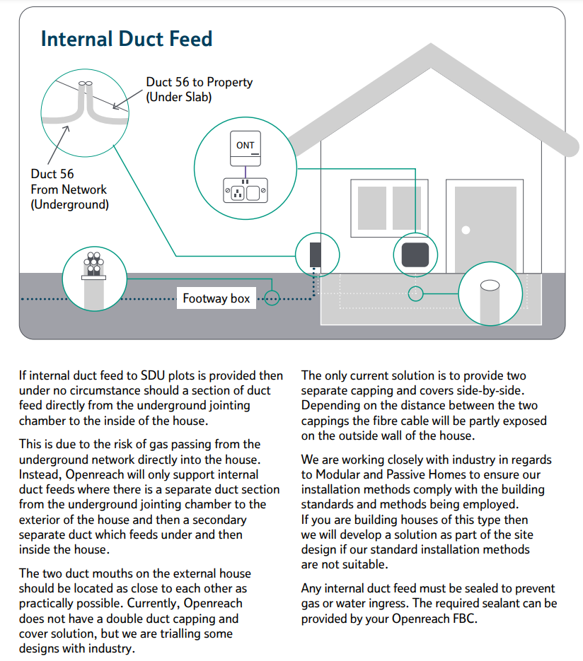

    There's some guidance on the Openreach website regarding passive house construction techniques, and they say they're working on something but basically the way to get the cable in without drilling through an insulated wall is to run conduit down the wall, through an uninsulated part below the internal floor level, and back up again to wherever you want the outlet. I would use 25mm conduit and a maximum of two swept bends on the route, then call VM and pay the £25 charge to redo the cable, and have them push it through this conduit. Then you're sorted for any future change to fibre as well.
    Obviously VM isn't Openreach, but the principles are the same.

        I don't need to relocate the box, it can stay where it is, I just need a new cable from the box into the house via a new hole which I will make lower in the wall. I plan to use some PVC conduit to make it easier.
        When I say 'loose' I mean the white internal wall fitting is not currently fitted to a wall, so it would be good if the new cable can just be connected to the fitting and then I will attach it to the wall when I can.
