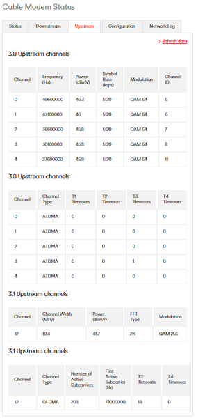

Hub5 logs:
23-02-2025 12:47:56    critical    16 consecutive T3 timeouts while trying to range on upstream channel 8;CM- "----"
20-02-2025 20:36:59    critical    16 consecutive T3 timeouts while trying to range on upstream channel 8;CM- "----

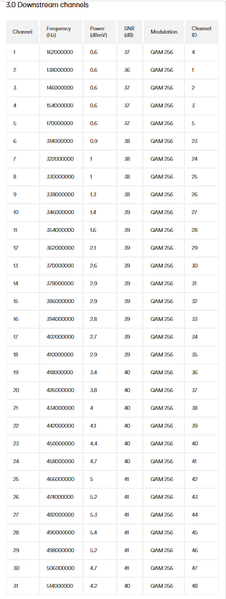

Power Levels:

    It’s interesting that the T3s message identifies channel 8 and the stats only show 1 error on channel 8. Have you reset the hub before taking the stats? Could we please have a copy of the full log messages, but use copy and paste. Photos will Not be accepted as they will contain MAC address, but the board software will replace them with ********s if you paste them into a message.
    I often get "Your primary internet Virgin Media was disconnected and has been restored." from my UDM-Pro, but the system recovers with no problems.

        Power levels are fine, don’t know why you cannot copy and paste, I do it all the time from my iPad Pro, doing it now with some instructions.
