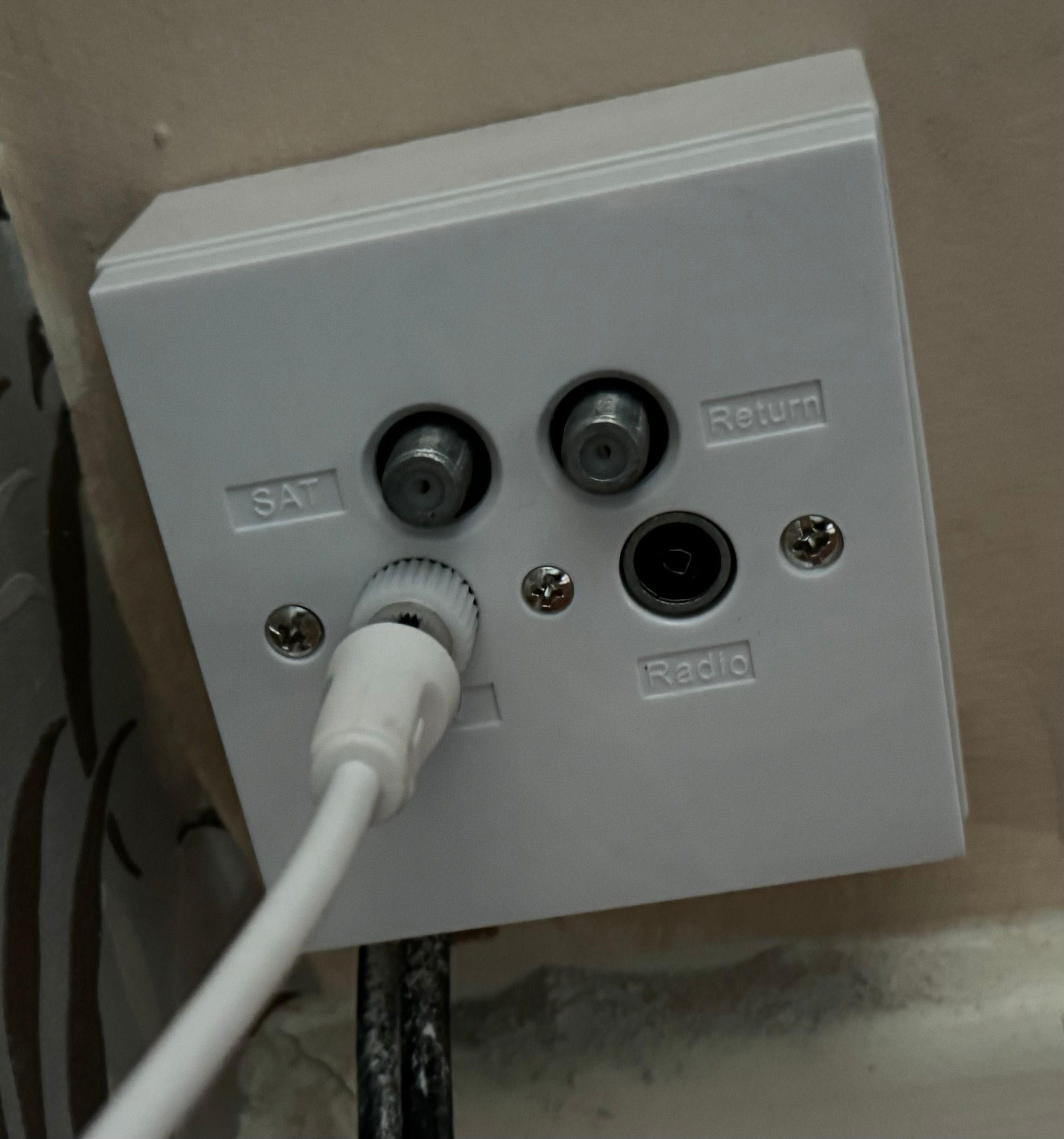

      The housing association agreed with virgin to install the cable into the Intergrated Reception System a few years ago and the coax cable for all tv inputs comes into the flat. My old neighbour had virgin installed but has left now but I took a photo of the socket with the Virgin coax connector with the satellite etc
    That is the first time I've seen this faceplate on the forum.
    The key question remains,  who is responsible for installing that socket in your flat ?

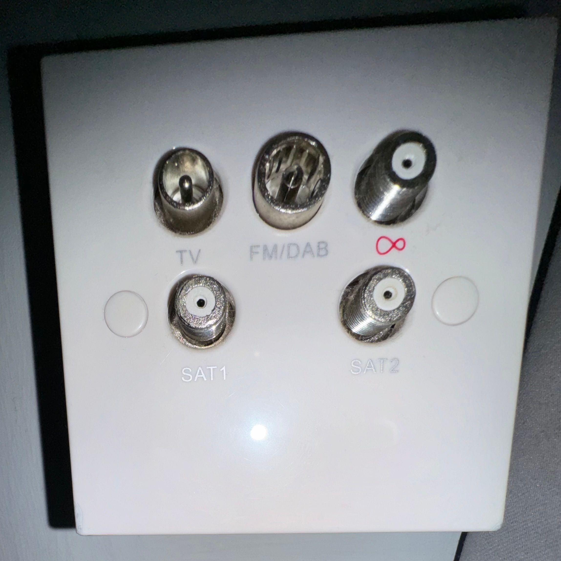

  • Update. After talking to SCCI alphatrack who said no appointment received by Virgin Media to change the faceplate and then contacting Virgin Media my appointment for the faceplate swap (SCCI) is now Wednesday 11th and the virgin media engineer the following day. The person I spoken to was helpful and apologies for the delay and got the appointment with SCCI. At least now I have appointments for both.
    • Davedoubledecks's avatar
      Davedoubledecks

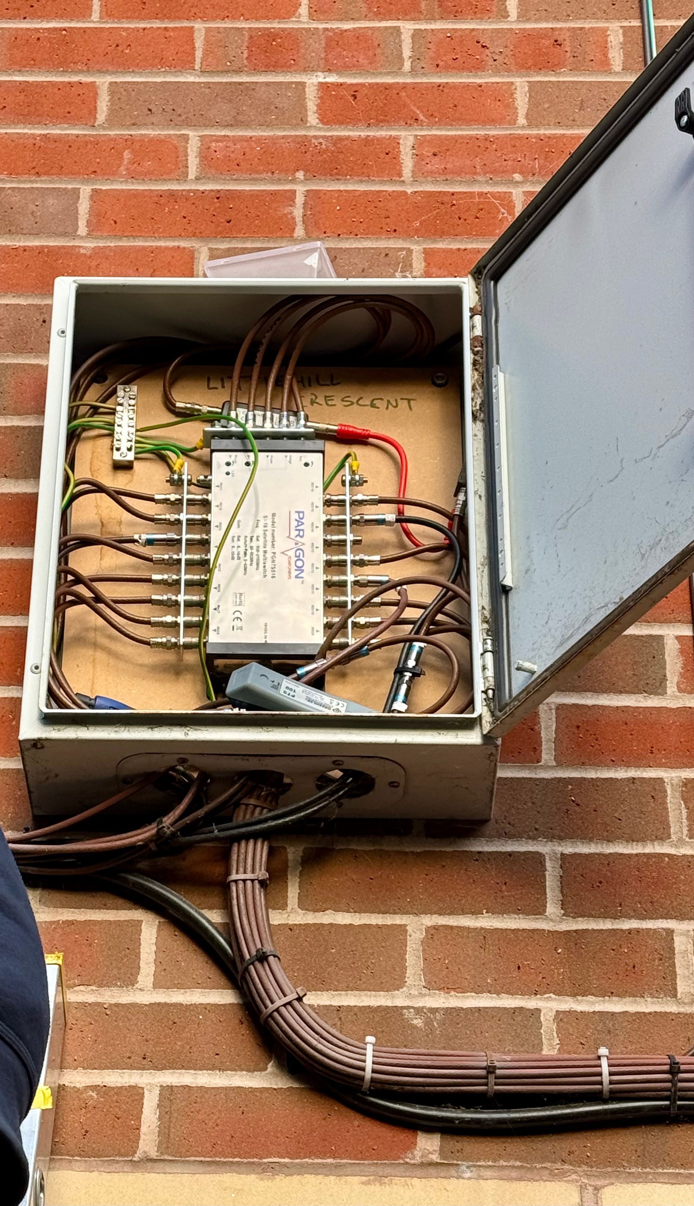

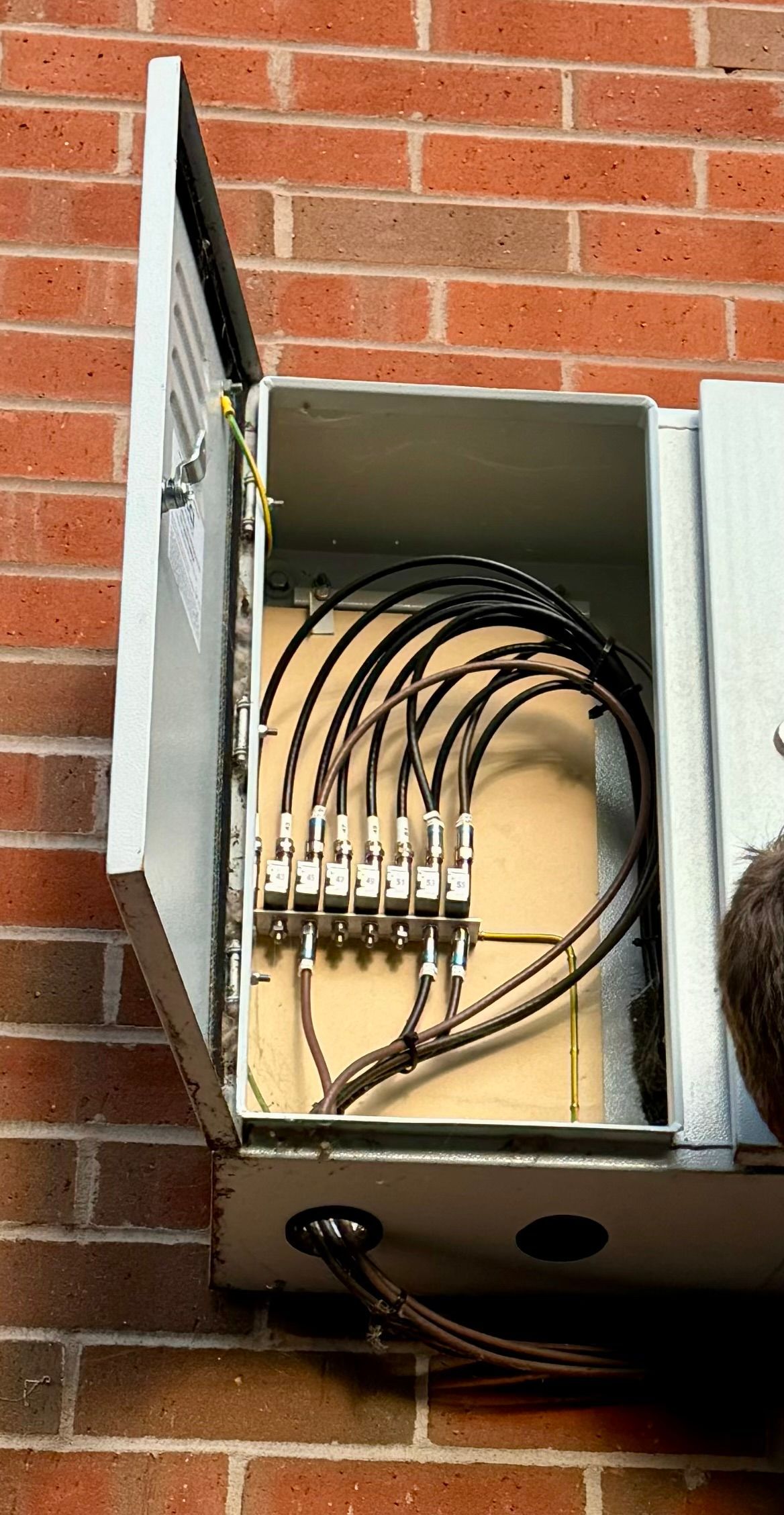

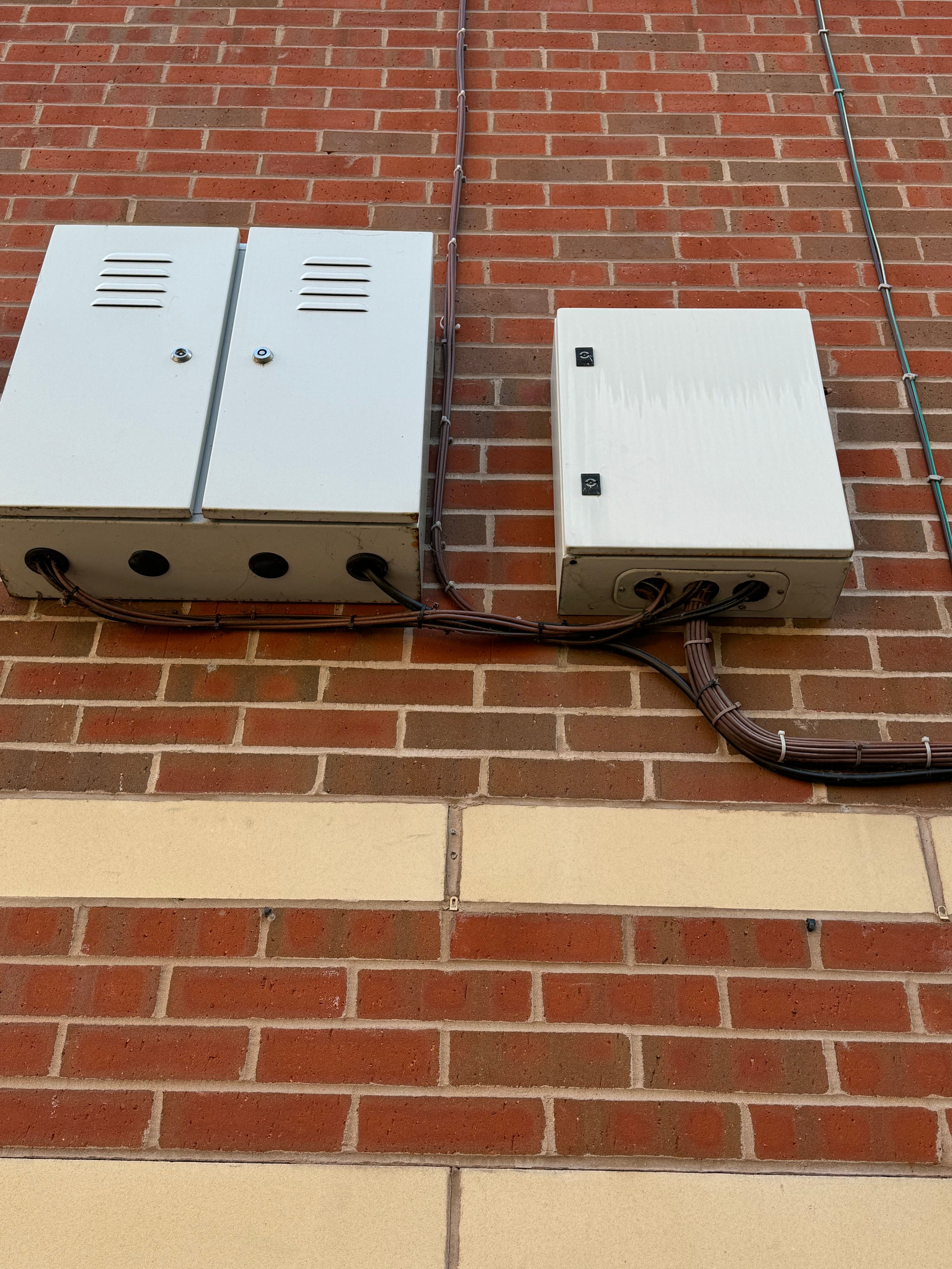

       Well I’ve got the first part of my installation completed on th virgin over IRS system so just the virgin engineer to come in the morning after it was it was moved from this afternoon to get connected.
      so the first picture is the virgin box where the cable comes from the street and then the engineer runs a coaxial cable to the next box and now uses one of the cables going to my flat for tv say etc for virgin media.
  • Roger_Gooner's avatar
    Roger_Gooner
    The first is the primary lockbox. How many flats in the building?
