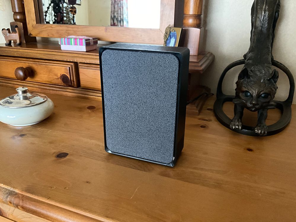

Hi, can anyone explain why I only get one device connecting to my pod (which is a mobile).  I've placed the pod in the next room to the hub. My sons room is directly above the room with the pod in but his pc only picks up the poor hub signal. He needs his PC for Uni. So not sure what else to do. Thanks
6 Replies
  • I have 3 pods, the black rectangular ones, they connect to the hub automatically after a couple of minutes, they extend the WiFi from my hub 5x very well, don’t understand how the pod is just connecting to the mobile, it should just blanket the WiFi throughout your house/flat etc. you might need another pod, you are allowed 3 & get them free if your on the gig1 speed
