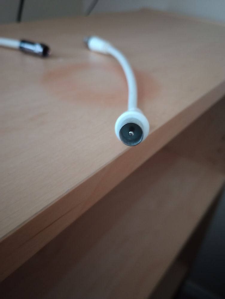

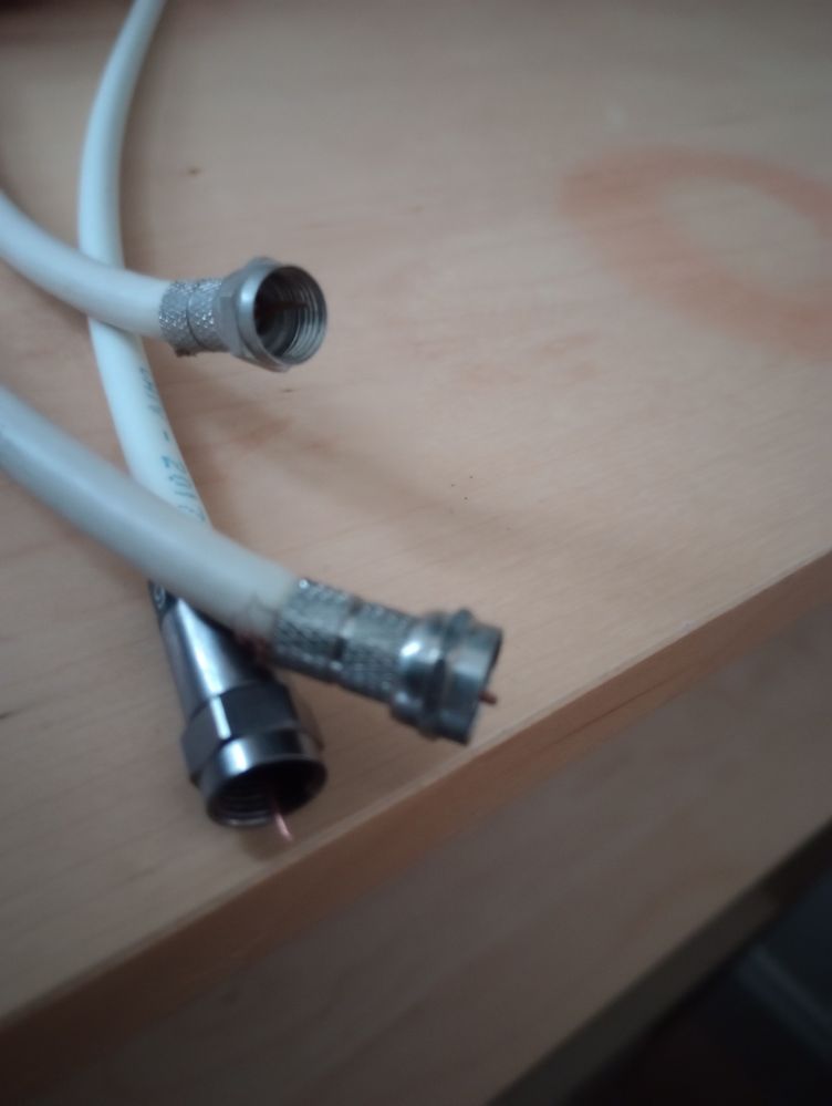

However, I found 3 cables coming from a hole in the wall shown below:
The hole in the wall where these cables are located is right next to the television.
Is it likely that one of these is the broadband connection that plugs into the hub?
One of the cables originally had this adaptor attached to it, not sure if that provides any additional clues;
I haven't received my hub package yet so I can't test, just wanted to make sure I have a broadband connection in here.

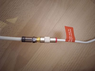

    You should try the cable/plug trailing from the wall in photo 2 with the black band on the metal connector (probably marked Cablecon, the same plug out of focus in the background of photo3), you will need a coupler adapter to join two plugs together
    https://www.diy.com/departments/slx-coaxial-connector-19mm/5028422001905_BQ.prd
    Also available from the likes of Screwfix, Homebase, Toolstation etc.
    If you post some more photos of how that cable is presented, then it might be clearer how best to connect it.
    You might be able to connect that cable direct to the VM hub BUT you would need to be sure there was an isolator component somewhere in the connection before trying that.
    If you use the B&Q adapter mentioned above, you can use the cable from the Quick Start kit which does already have an isolator in line. The B&Q adapter is a screw fit connection, the Quick Start cables are push fit

      Yes, that cable with the black band is labelled "Cablecon 3.9"
      It's the cable at the bottom in the 2nd picture of original post, is there any particular detail that you would need to see?
      After the head of the cable shown in the picture, it's just a plain old white cable all the way down as far as I can tell
      Any idea on how to establish if it has an isolator component? Also, what happens if you plug it in without one?
      Thanks you
      • goslow's avatar
        goslow
        The Amazon item you originally posted (then removed from the post immediately above) with the F-connector coupler is the same thing if you happen to have that already. They are generic parts. Try with the adapters you have when you get the VM equipment delivered.
        If your adapter screws into the Cablecon connector OK, use that and push-fit the lead from your Quick Start kit onto the end of it.

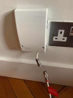

  • Ok, I've got my VM hub and I've used those adaptors to connect the Cablecon cable to the cable provided in the VM package and connected that to the hub. Shown below
    However, the Hub doesn't seem to get a connection, the Wifi symbol is green but there has been a green flashing light at the bottom of the hub for more than 30 minutes.
    Any ideas what to do from here?
    btw I traced the Cablecon cable and it goes along the skirting and then in to a hole in the wall which goes outside the flat somewhere unknown.
  • Turned out the tech needed to restore the connection outside the flat, all sorted now 👍
