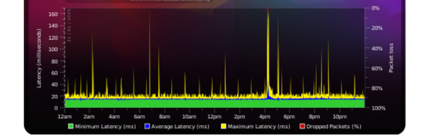

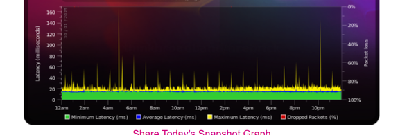

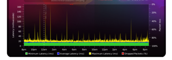

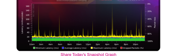

    • klayton88's avatar
      klayton88
      My router is in modem mode yes, using a Deco x20 as the router. Never had issues using this set up when the house was GIG1 with a Hub4. Now I'm M350 with a HUB3, still running in modem mode because the speeds and coverage were abysmal with the HUB3 over WIFI.
      I only really play a handful of games but the most noticeable are multiplayer games which require a steady ping, Rocket League, COD, PUBG.
      I've ran the HUB3 in both modem mode and router mode, wired and unwired, and for about 30 seconds of every hour I'll get massive lag spikes and packet loss before it settles down like nothing has happened. No connection drops, no low speeds, just 30 seconds of madness where it ruins my games. It isn't the Deco unit as it happens when using the HUB3 in router mode, wired or unwired too.
      See attached pictures from the last few days from BQM.

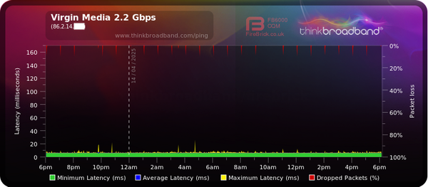

  • VM are definitely doing disruptive routine jobs on their network. Here are my Broadband Quality Monitor graphs. Like clockwork the packet loss hits, games are disrupted, calls can be interrupted etc. I only used ethernet connectivity and not wifi, although this BQM is measured externally and therefore excludes my equipment. I have a 2.2 Gbps link and that performs beautifully except for the hourly slabs of packet loss.
