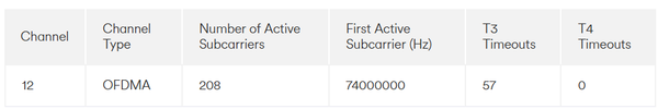

When I look at the Hub5 Upstream & Downstream Connection logs from the V5 Router Status, I'm seeing a lot of critical T3 errors in the status, primarily on the upstream connection:

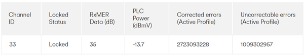

Additionally, there is alot of error showing under the downstream connection too under the "Uncorrectable errors (Active Profile)" heading:

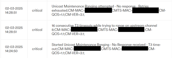

Further investigation on the Network Log shows this error as the source of the T3 error:
Whilst I can't seem to go back anyfurther on the Network Log, the T3 errors seems to correlate to outages reported by Unifi.

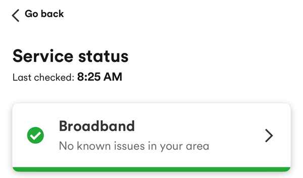

      Many thanks for your recommendations! The service status of my Broadband has always been showing as ‘No known faults in your area’.
      I’ve always found that contacting VM on the phone is a nightmare!

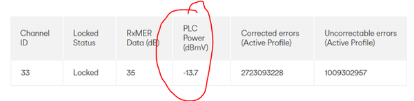

        If the Downstream power levels also out of spec for the DOCSIS 3.0 Channels that may also be resulting in many more errors.
  • There are 14 downstream DOCSIS 3.0 channels that have a power level of greater than -7dbmV. The highest is -11.6. I cant post a table here for somereason!
    I was hoping the Forum Mods would step in here. Considering my line isnt technically showing a fault, it will be an uphill battle trying to convince the first line support people that there is actually an issue!
    Signals between -7 ranging down to -11.6 dBmV are all below the normal operating range.
    An engineer is required to correct this before it becomes a total outage.

  • Update - Engineer now booked (had to accept the £25 engineer fee for them to believe me that there was an issue). Interestingly, DOCSIS 3.1 power level has now increased to -15!
     We are looking at negative logarithmic power figures.
    -15 dBmV is a lot lower signal strength than the previous -11.6 figure.
